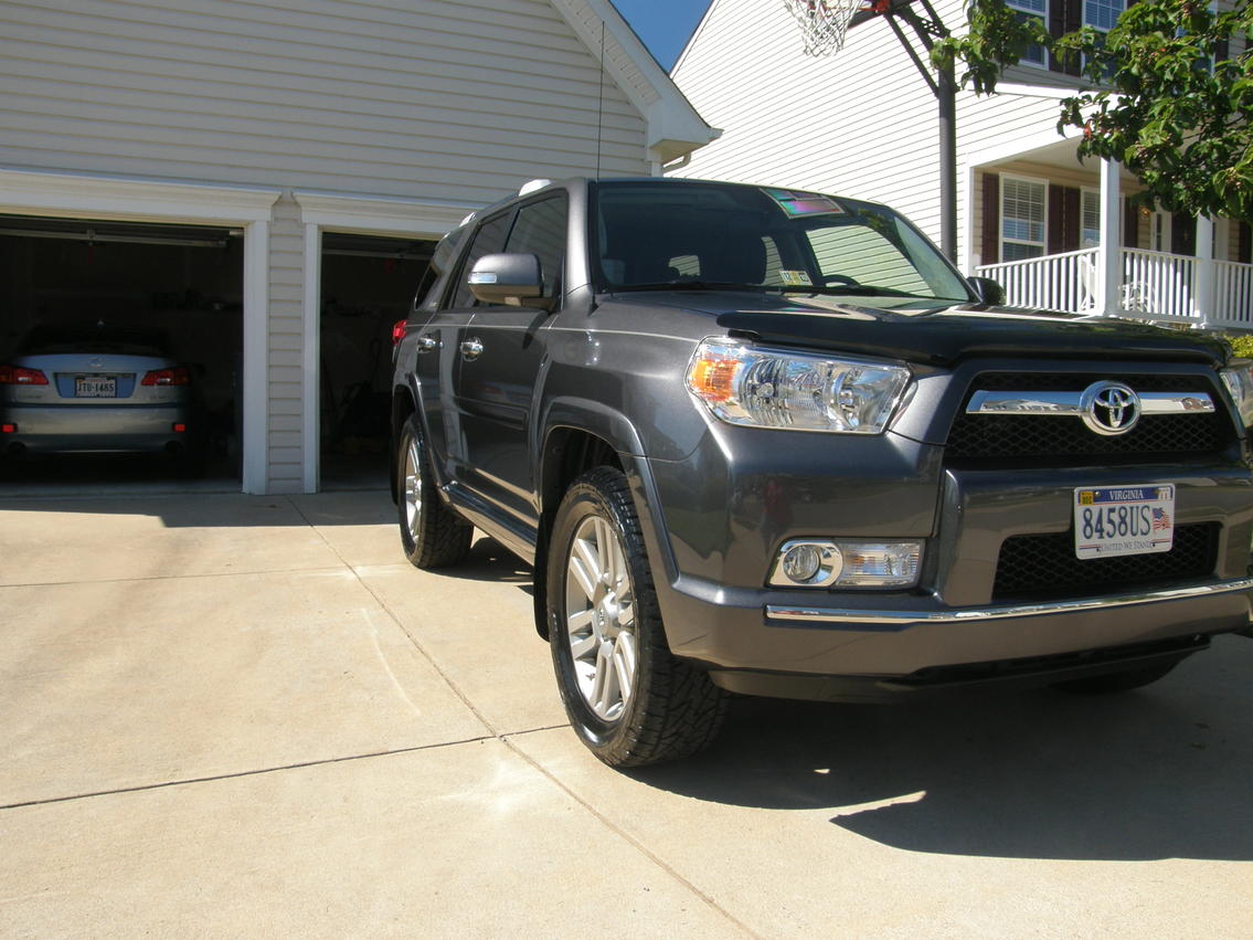

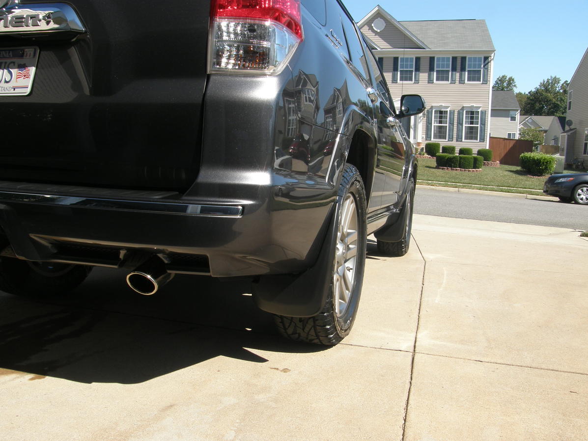

There's a lot of debate about what size. I'm running 275/55 Bridgestone Dueller Revo's with no problems. No rubbing, speedo is fine, no issues at all. I'm very pleased.

Thanks guys, heygenius your tires look great, and I do see that a lot of guys on the forum have used the same size as well. Have you taken any trips on the highway or at high speeds yet with the new tires ? If so any issues ? Do the new tires have a beter ride then stocks on impacts like pot holes with the higher side walls I am guessing bumps and pavement seems are probably a little less harsh.

I recently drove to the Adirondacks and back from Va - about 1100 miles round trip. They were smooth and quiet on the hwy, although not quite as smooth as the stock tires, but pretty close. I didn't notice any difference in gas mileage either. I had these on a gen4 and was very pleased with the performance. Seems to be a pretty good balance between nice quiet ride, and offroad traction (offroad in my world which is basically some snow in the mtns and forest service roads - nothing hardcore at all).
