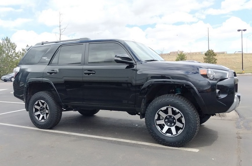

I was thinking it looks like Icon suspension (but the 90 degree bend makes me think Fox) with Total Chaos UCAs, the PRO grill (hard to tell if dipped or pro valances) and the fact that their listing says it's a SR5 makes me think they want it gone or don't realize how much is in that truck.
If it drove well and visually looked okay, I would say that seems like a solid buy, compared to spacers. You just just swap tires and have a great looking rig!

Looks like Fox to my eyes. You can see the front resi is mounted vertically. Icon is mounted at a bit of a tilt. Also the rear resi loos like it's mounted piggy back style. Most likely a Fox 2.0 with resi in the rear. I mean if it's clean, no accidents, clean underneath seems like a good deal to me.

I agree, I'd jump on this if everything checks out, and you can verify that the suspension was installed professionally. I think it's fair to say that the lift setup cost the previous owner a few grand, and it's practically brand new. Whether it's Icon or Fox, that's a high-end setup either way. If you were planning on modding, you'll be getting a high $$$ mod for pennies on the dollar.
Of course, if you don't care about that, then you should probably pass. These aftermarket parts will require ongoing maintenance, and probably aren't ideal for someone who never intends to take it off road.
