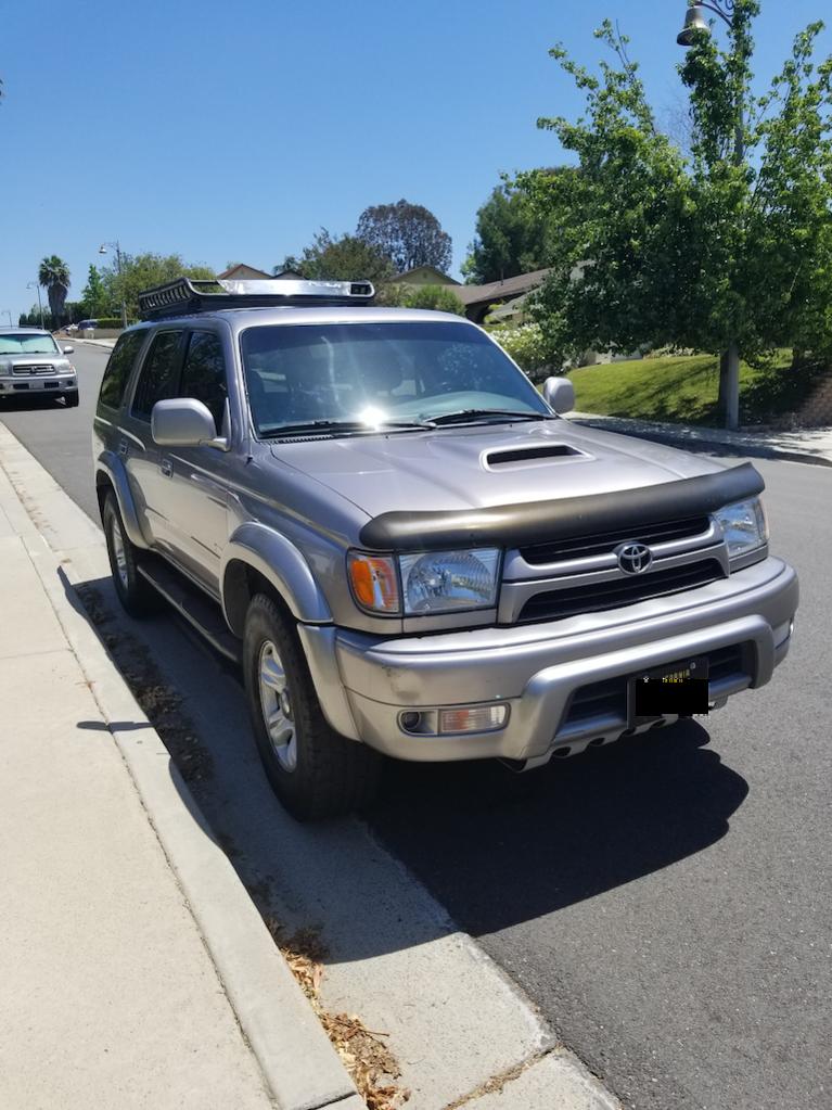

Thought I'd take a few minutes and introduce myself and my car. My names Cody, and I picked up my 2002 Thundercloud Sport Edition 4Runner with 184k on it in May. I had been looking for the right one for about 3 months, trying to be patient. Eventually after looking at many bad cars, this one popped up in Long Beach and I jumped on it. Paid $6600 for it with the S/C. Had the steps/roof rack/subs in it already as well.
The only real problem with the car is the rust. Its lived in a few different states in its life, spending a lot of time in Colorado, Indiana, and Tennessee. Most of it is surface rust that I can get off, but we all know how appearances can be. Its had some not-so-great paint touch ups on the bumpers and fenders, and the roof has been repainted (almost professionally, I can see the tape lines...)
Im getting ready to move to Arizona for school, so progress will be slow until I can get situated over there, but I'm happy with where the car is right now. Hopefully my impatience can be kept at bay for at least a little while :biggrin1:

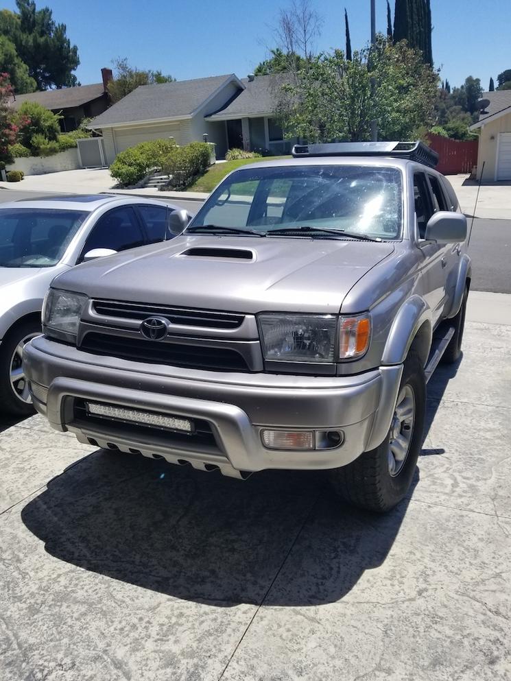

Currently done/installed:
2nd Gen TRD Supercharger (with rebuild)
TRD Intake
Dynamic Tensioner
B&M Trans Cooler
ScanGauge II
CB Radio w/ Antenna
Borla Muffler (welded in)
Rola Roof Rack
Front Tundra 5100s wrapped in OME 880s
20" Bumper Light Bar
Various Rocker Switches

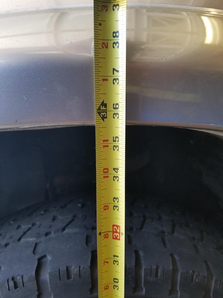

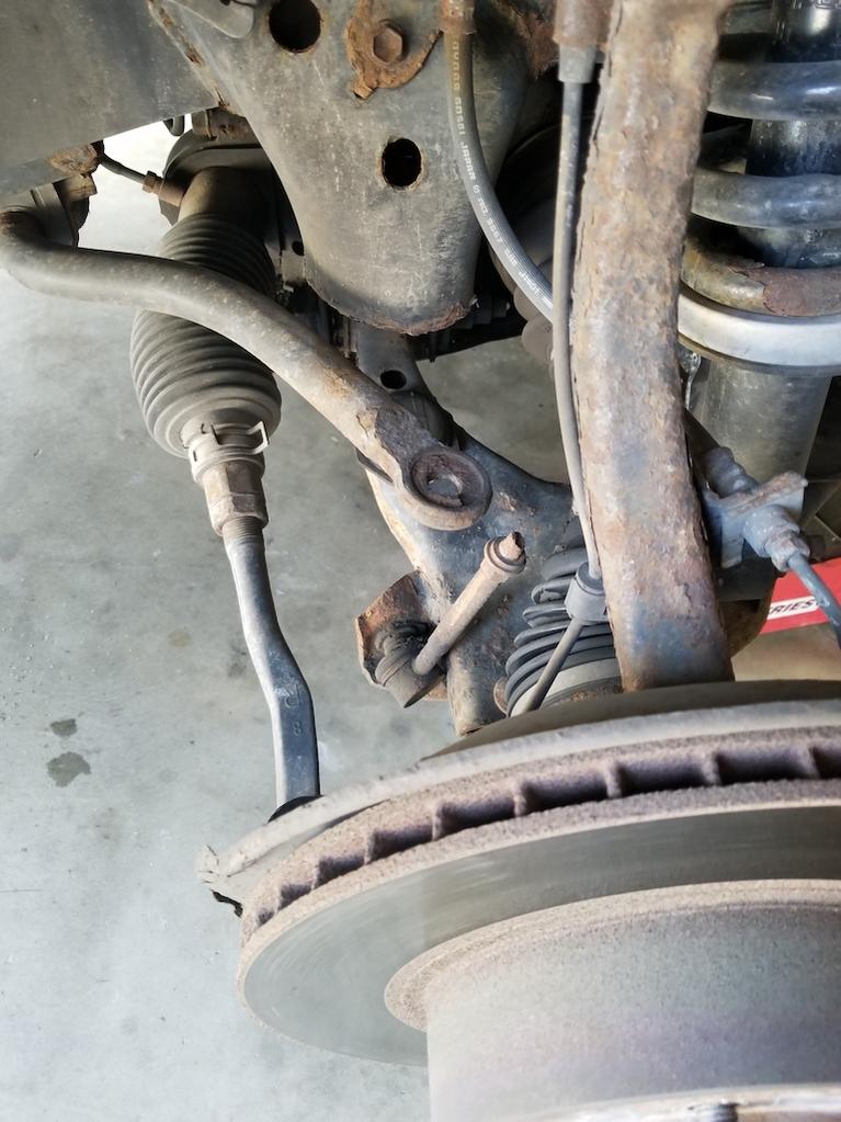

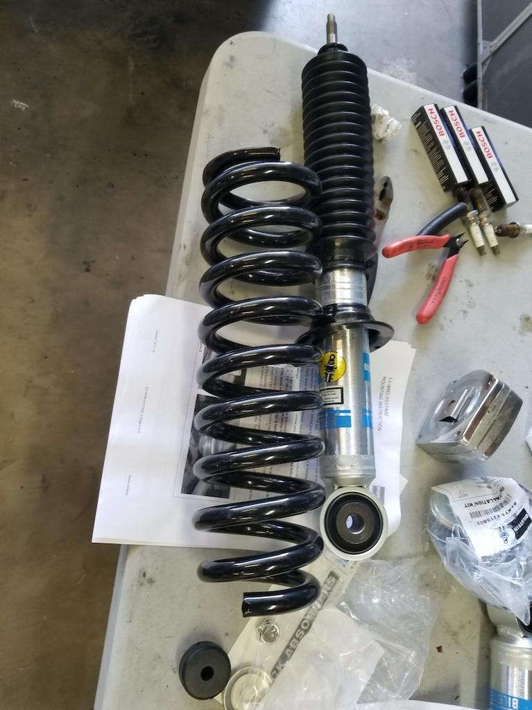

Yesterday I installed the Tundra 5100s and OME 880 coils up front. My suspension was factory original, which meant 15 years old... I was coming back from Arizona and my suspension would bottom out and my tires would scrape. So I had to bite the bullet and get new parts. Im too poor to afford all four corners, so I installed the 5100s at the lowest setting until I can get a matching rear setup. I also had a broken sway bar link, which obviously caused most of my problems. But I wasnt about to return the shocks and coils so ... Bought the Autozone special end links at $22 a pop until I can get the Addco sway bars/links.
Ride is much much much better. Its stiff, but I like it that way. Ride height changed about 3/4" each side, but I'm sure most of that is from the old coils being crapped out. Sits at about 35.5" to the fender currently.
