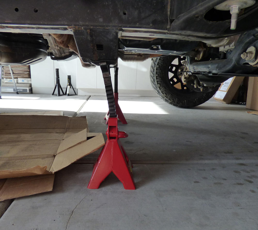

So I am working on the lift, and have most of it done. I have replaced the front coil-overs, upper control arms, rear shocks and rear coils. Nothing traumatic happened and things went fairly smoothly for once, although it took a really long time to complete. Unfortunately I have to spend about 2 hours cleaning for every 30 minutes of wrenching. So what should have taken 5 or 6 hours took 20. Straight through with a couple quick trips for new jack stands and meals.
So I finish up fighting with the front sway bar brackets. They are being a pain. So here is the one negative thing that did happen. I dropped one of the brackets and it fell perfectly splitting me head open right above the eyebrow. Luckily it wasn't my eye.
Anyway, on to the stupidity part. I am cranking on the bolts for the sway bar and re-installing the skid plate, all the while laying under the truck. Get it finished after a trip to Walmart to find butterfly closures for my head and Home Depot to find longer bolts for the skid-plate.
I decide I need to paint some of the rust spot underneath. As I am getting ready to crawl under again, I notice something weird about the jack stand. What hell? Thn I look at the other side and see it has slipped off and is hanging on by less than a 1/2". And all of this time I am laying under the engine just torquing away on bolts.
I am really lucky one side or the other didn't give out. These are 3 ton stands. Looks like I will be getting a second set of new stands. (at least they will match now) This is why you don't work on a vehicle for 25 hours straight.
(And no, the front tires were not installed at the time)

I have had those for years. I just picked up a 4 ton set that are holding up the rear. Will get a matching set for the front as well.
Jesus man- that pic gave me goosebumps!
Yeah- get some bigger jack stands if you want to work under there and CHOCK YOUR WHEELS.
Tip- I always put my wheels/tires under the truck while working on it as a backup to the jackstands. Like this...
Damn....
Take that piece of crap back and get some new ones on their dime. Get some heavier duty ones now.
Honestly- it wan't that they were pieces of crap- it was complete user error.
They are extended waaay too far and on top of that I would bet the wheels weren't chocked. You can see that the truck moved backwards causing the bend and the other to slip.
I think they did an outstanding job given the circumstances and saved his ass!

Man. you are lucky. So many things wrong in that pic.
1. Jack stands are over extended and way too small (yikes). 6 Ton...
2. They are positioned too far back (put them up on the frame as far forward as possible or on the forward cross member)
3. Get the rubber boots (hockey pucks...) to create some friction vs metal to metal
4. Add some backup stands or some other last resort measures.

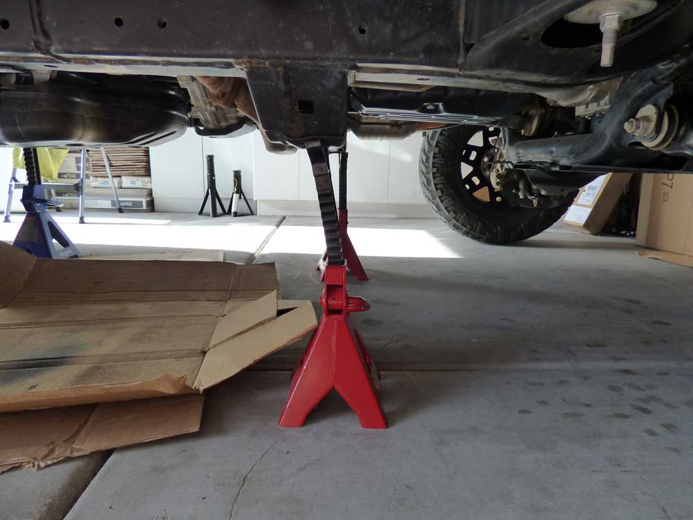

You are right in that the wheels weren't chocked as they weren't even on the car.
In this wider view, you can see the larger new stands towards the rear. THat was the only place I could put them to make them work, They were far to short to reach the frame.
But it was definitely a case of improper usage of improper tools.
Although the blue one looks like it is leaning, it's just the angle of the shot.
I did have the tires under there but pulled them out to crawl underneath.
But all in all it was pure stupidity on my part. :sorry: (the good thing is that I have been fixed so can't breed :welcome: )

Those jack stands are plenty big. I have two 6 ton stands and two 2 or 3 ton stands (can't remember right now) and have worked on the 4Runner and my previous vehicle which was a 1987 3/4 ton Suburban (i.e. heavy as hell) with the smaller stands. Never had all four wheels off the ground at the same time, but even one two ton stand can support almost the full weight of the 4Runner. It's fine when doubled up with another one and with the back wheels on the ground. Make a big wide base out of two or three 2 x 12s to put under the smaller jack stands so they don't have to be extended so high. Then you can put them further forward under the frame rails.
I think I know when it happened. It was probably when I was jacking up one side of the rear axle to get the new coils in. I was trying to be carfeful to not lift the vehicle off the rear stands, but probably did just enough to allow the weight to shift.
I should have left the tires on the end I wasn't working on just for stability.

Something else to keep in mind with jack stands is that they are typically rated as a pair. This means that a pair of 3 ton stands can support 3 tons when distributed equally over both stands and that a single stand is only good for half the load rating; in this case 1.5 tons. 4Runners aren't light vehicles, and 3 ton stands are cutting it a bit close for my liking (example of why). My preference when working on an SUV or truck is to use a pair of 6 ton stands per end. The extra load rating is peace of mind knowing that a single stand should be able to hold up half the truck if necessary, but the significantly larger base size used on the 6 ton stands provides much needed additional stability as well.
