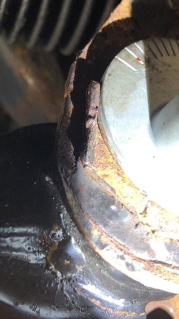

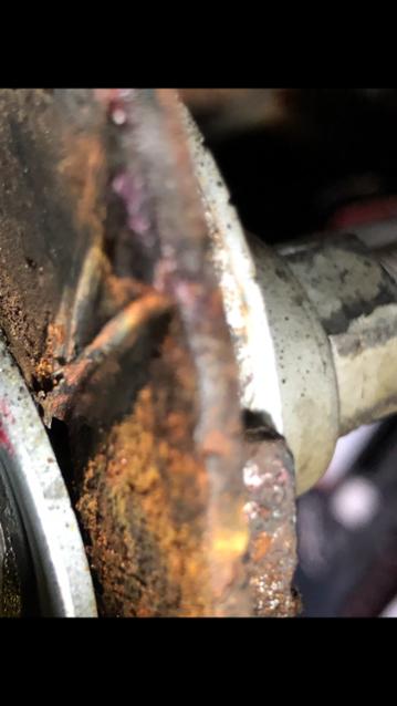

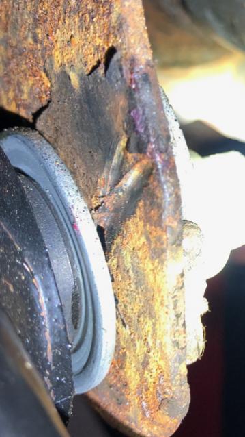

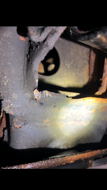

Hey Guys,
I need help on this one.
I bought an 06’ V8 rig recently. Great deal. Not too much rust. So I went to do a complete suspension refresh (LCA, 5100s, OME, Freedom UCA, sway bar bushings and links all around). Did most the work myself, however, I let the “local” shop remove and install the new OEM LCA.
The shop said they were “like hell to get out” but I didn’t think twice about it and went ahead with the rest of my maintenance I had planned — all told $5k+ with new timing belt, brakes all around, suspension, and more.
I finally finished most of the work myself after almost a month of her sitting on jack stands in the garage. I take her to the Toyota dealership today to get her aligned and they tell me this:
“We can not get it aligned properly, furthermore there is damage from whomever took off the LCA, come look.”
I then proceed to come look underneath the rig and there are multiple places with cut marks from a saw on the left side (driver), and one of the cam tabs on the front pocket looks bent, albeit not totally flat. Toyota said it can not align the caster and these gashes on the cross member and LCA pockets are “concerning”, possibly could fail.
1. What do you guys think of these pics... do I need to replace these pockets/am I screwed or is the Toyota tech making too big a deal about this?
2. Is the reason the caster won’t come in properly on left side because the tab is bent or the pocket could be bent (Toyota said due to heat)? It also appears it won’t stay aligned, as when I did leave after alignment I hit a bump later that day and steering wheel seemed liked it got off center a bit..
Please give me your opinions. Do I need to start welding and suing the local shop (being dramatic) or is it not really that a big a deal with these gashes?
The Toyota tech thought it was, however, he couldn’t align it properly so he might of been looking to pass the blame around. Not sure - couldn’t tell.
Thanks guys. I read here all the time and respect your input more than any shop/dealer.
-Jon

59860 - Total Chaos Lower Control Arm Cam Tab Gussets
Same Rig as me -- silver with the Trail Rims
Yes, I've seen those. However, the gash thats up against the bushing in pic 3 and 4 would not be addressed by the cam tab kit, I believe. That gash is on the flap itself and not the tabs that you weld in.
What did you think of the pics?
With the additional strength of the gussets I think you will be fine. Sucks that happened though, makes me glad I suffered through doing my own haha

Yea, I kinda regret not doing them :/
I kinda feel like it’s a tossup. Part of me feels like it’ll be fine and it’s probably not that big a deal. While another part wants it to be right and not have to worry about it.

Structurally I think you're fine.

Yea, my hunch is that too. The one part that freaks me out is the tab that has the slice down to the bushing. That piece of metal is only about 3mm thick as it is. That gash is about 1mm deep.
Oh and I forgot to mention, the tech had me feel that whole pocket and when you run your fingers against the outsides you can feel a slight bend in the metal that kinda sinks towards the bushing.
Didn’t feel it so much on the other side. He said could be from heat and metal fatigue. Hard for me (or him really) to know.
I saw other posts you wrote about your tabs/gussets. Did you eventual go chaos?
The gussit kit will bring the integrity of the metal back. I would pull the LCA off and probably have raised gouges on that part that the bushings are contacting by the looks. Can grind them down flat with the rest of the pockets.
Personally, after the grinding/clean up, if there's too much slack with the LCA in place, beat the pocket tighter. Should be snug, having to force the LCA in the pocket, then weld the cam kit on per instructions.
Interesting you’d say that about the raised gouges. The Toyota tech said too that he wouldn’t be surprised if that gash was actually eating into the bushing every time it rotated.

I dont really see too much that is concerning. the lower arms can be a real mother to get out once the bolt seizes to the sleeve. some marks and scarring is to be expected. they should have cleaned it up a bit. Im guessing the tech was pretty tired/frustrated after fighting to get them apart.

Having cut out the cams and replaced the LCA's myself, there really is no excuse for those marks. It's easy as heck to the bolts without messing up the mounts that bad. Sawzall and a decent blade it takes very little time and is a straight cut. Once you realize the bolts are frozen (a minute or 2) you pull out the saw and have at it. Shop would obviously give the customer a call at this point, but it seems they were already replacing the LCA's and hardware, so not sure that would even be necessary here...
That said, I agree that you should take it back to the shop and give them the chance to make it right.
Really the photos don't look too bad. I twisted those tabs a bit on mine getting mine out and hammered them back into place for the new install. Plenty of metal there to hold everything in place.
