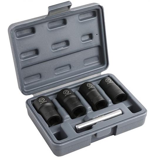

On another note, I recently got a set of lug lock defeaters (special sockets in 4 common sizes that bite the locks when spun counterclockwise) from Amazon for a Lexus my wife acquired without a lug lock key. Worked great with a 5lb hammer (to seat them well) and a breaker bar. They are supposed to work with an impact as well but I wanted to be stealthy.

Exactly, they're kind of a joke. Sooo many people lose them that you can even buy bundles of various different keys to fumble through until one fits. Mechanics buy them all the time to keep in their shop since even fewer actually keep the key in their car like they should. Sometimes you don't even need a special socket, just one slightly smaller to hammer on
