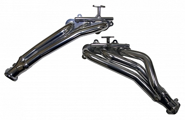

There does seem to be a discernible difference with some kind of port at the top of the newer version... if they're identical engines, what's with the extra port? The same is shown on the Doug Thorley website.
Anyway this makes me nervous about something changing in the O2 sensor department, meaning the O2 simulator from '10-12 models won't apply to '13-17 models...

So I heard back from URD, and the headers are indeed different. One may fit the other but there’s something unique about the 13+ units. Probably related to that extra piece on the top.
More importantly, there is no O2 simulator for the 13+ units. They do not have a reliable way to do it, thus they don’t sell it. You will always have a CEL if you put headers on a 13+ 4Runner. Unless you know something they don’t know.

That's very helpful information, and it also explains the additional port on the 13+ headers. From what you've described, that must be the air injection port.

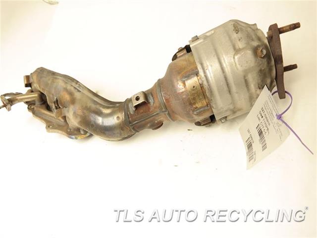

Here's a real pic of the latter unit, with the air port visible:
The y-pipe would replace TWO cats as well (from what I can see). Basically, everything up to part # 12:
