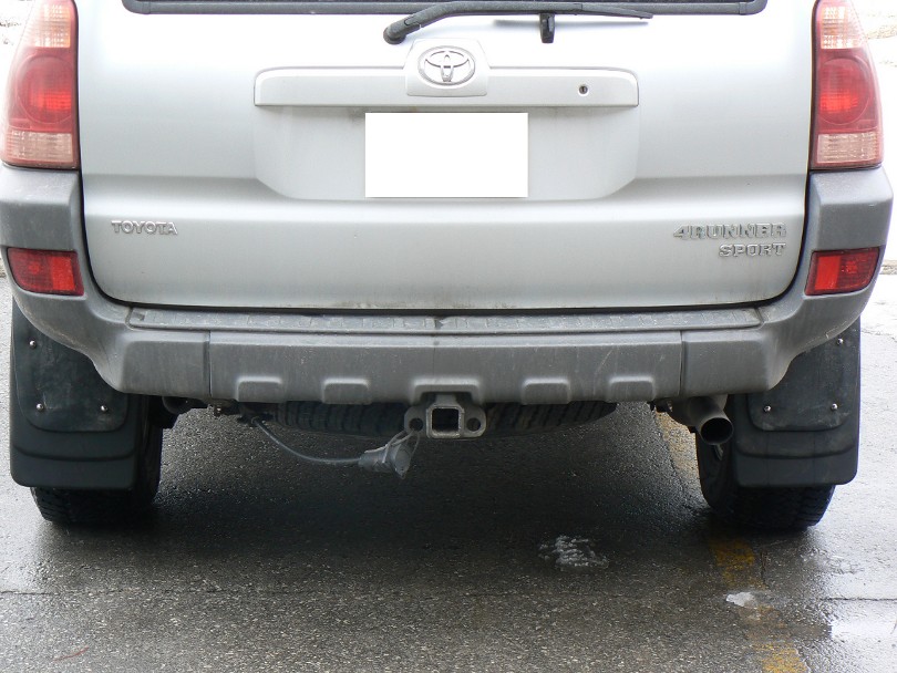

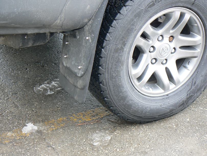

Solved
Here it is.
Thanks to 4RNNR for pointing out the Husky's Universal fit.!!
I like how the project ended up.
They are now almost 5" longer going down.
I still have more than 8" clearance from the ground.
I'm hoping that will do a good job keeping my trailers and bikes a lot cleaner.
I'm sure it will help.
Thanks again for your input.

excellent, I've never used them, so glad they worked out !
I can't quite tell ffrom the pics- are those riveted ? bolted ? screwed together ?
I just wanted to say nice trials bike, not too many riders around anymroe; my pop took me to a few competitions when i was a kid, very cool stuff.
I used one of the original screws - meaning it goes through the new one, the original one and into the bumper. The other 4 are stainless steel 1/4 inch pan head machine screws with the acorn nuts in the back. These are just through the original and the new one.
