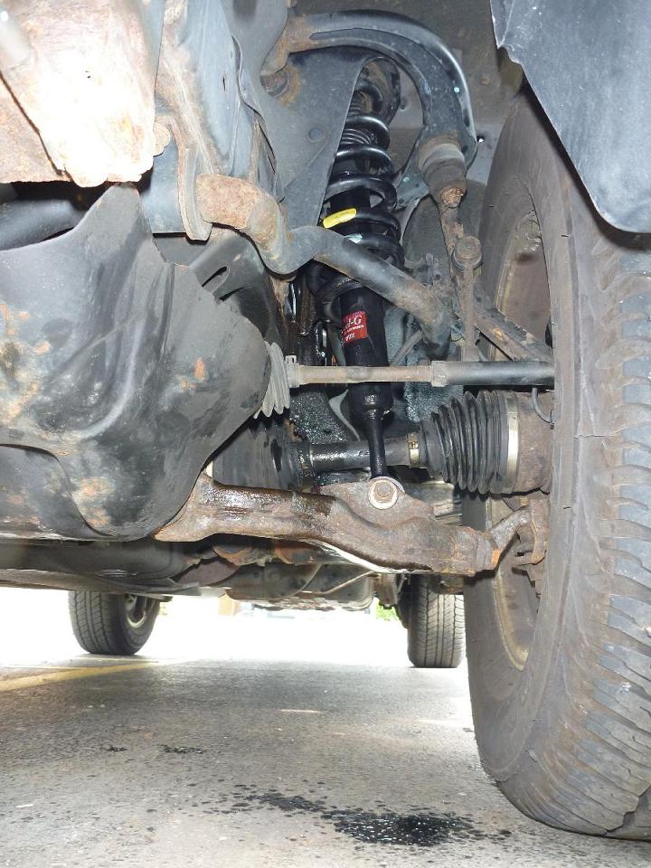

Secondly, the left front suspension was found to be leaking, I took a picture of it.
The dealership said that it's a leaky shock they'll replace it with a KYB shock(never heard of that before).

The control arm bolt above looks like it is getting ready to flake apart that means more replacement stuff. Rust is cancer.

As they said, id walk simply because it is priced too high for the mileage and service history. I paid 11.5 for mine with 120k and service records showing all scheduled maintenance was done at the local dealer. They are also trying to get by wth repllacing a $1500 suspension setup with a $250 one. Id say stock setup is much better than kybs (although there are other options). You aalso need to look. At the transfer case, there's a black box (actuator) on the back of it and leaks arre pretty common there the box bolts to the transfer case.

That doesn't look like a shock leak either. You mentioned the weak brakes, and it looks to me like that may be brake fluid leaking from some place.
