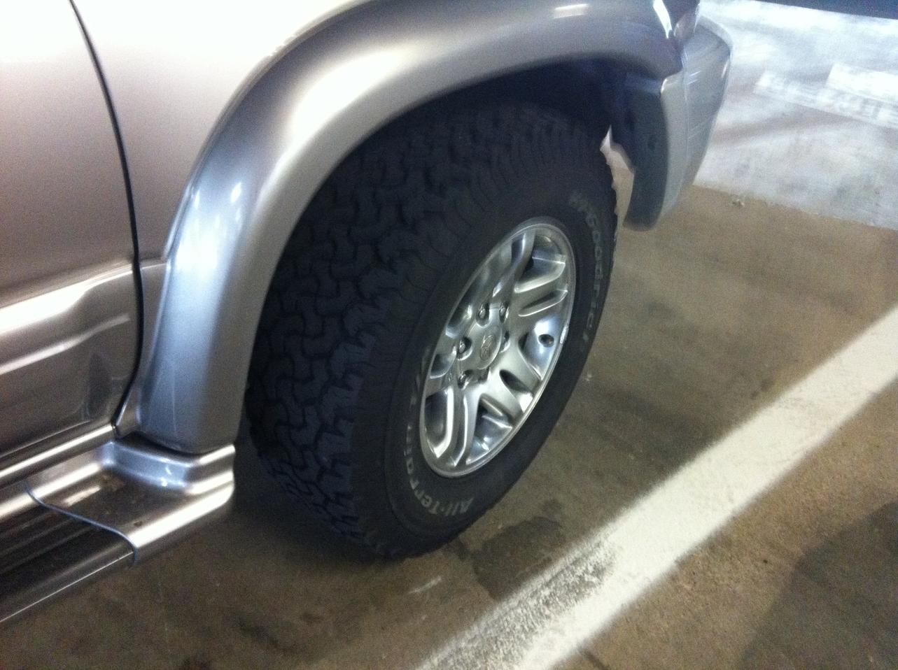

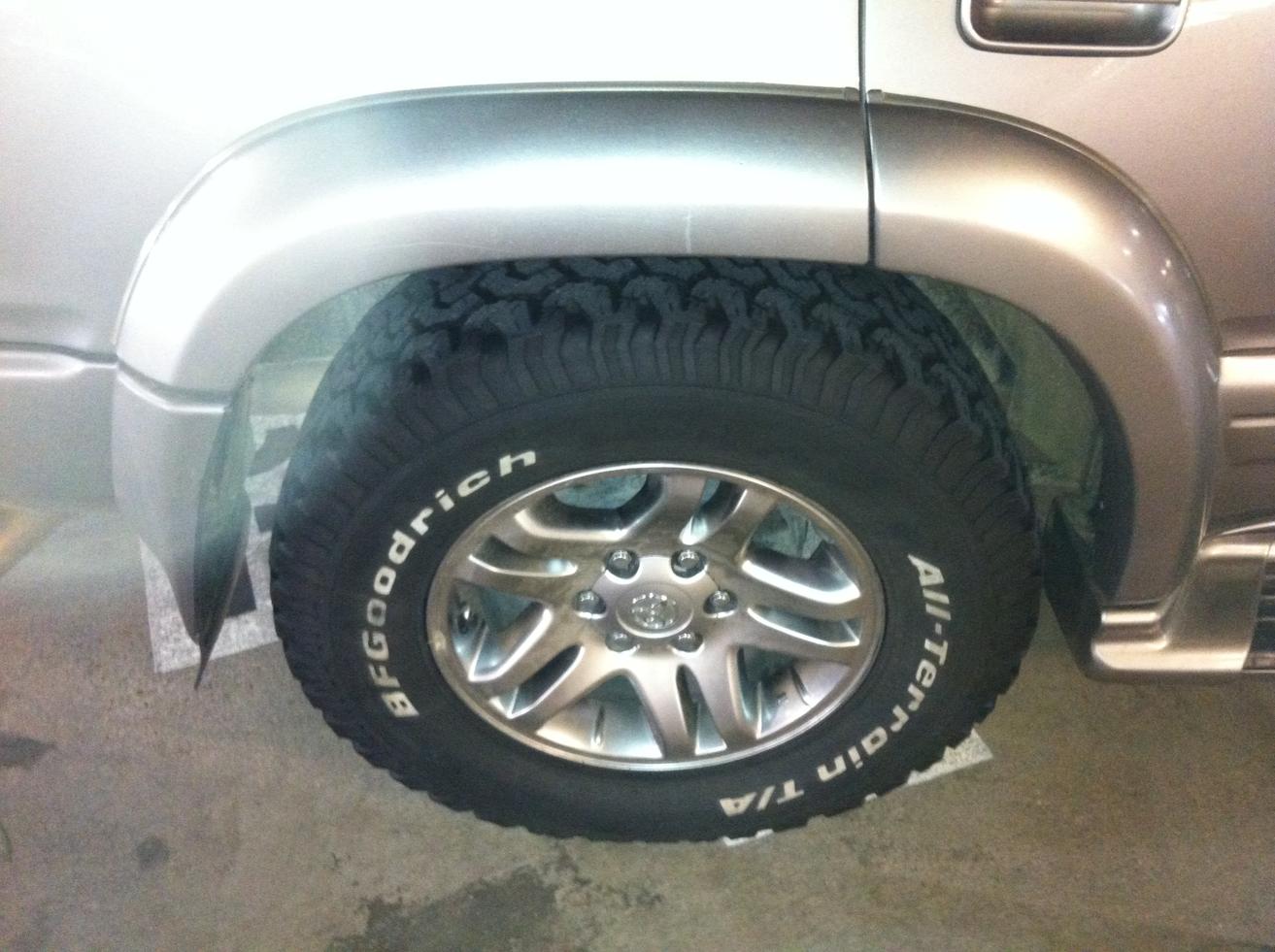

I just installed a set of 265/70/17 BFGoodrich AT's on my 2002 Limited 4x4. I have slight rubbing whenever I compress my suspension a pretty good bit. Not enough that I worry about it though.

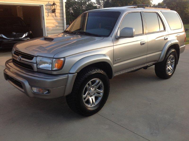

265/70/17. Stock height

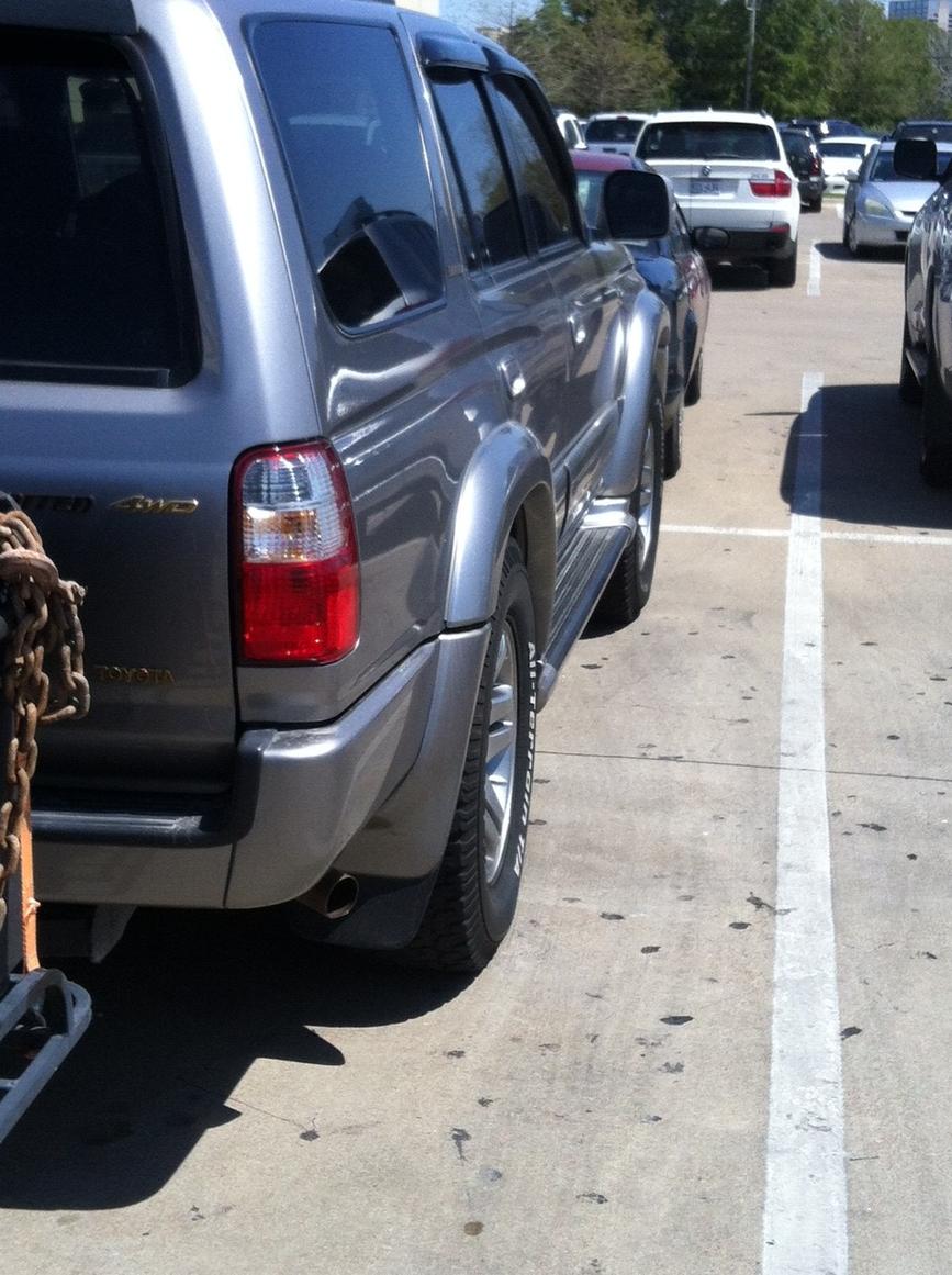

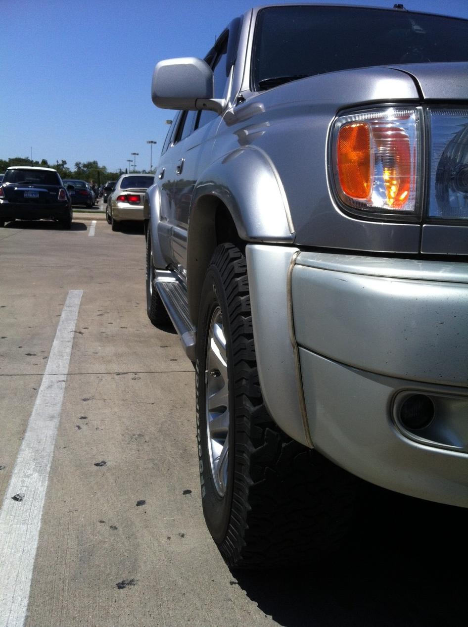

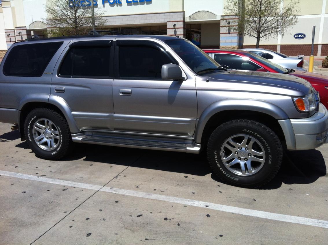

Here you go! Sorry they're not that great...I remembered and was in a hurry! They look huge on the rear because I have the factory saggy springs, not to mention a 150 lb. tool box attached to a receiver hitch cargo basket!
