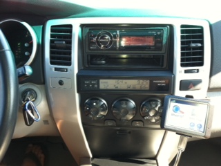

I just drilled a hole in the blank cover next to the A/C controls and mounted the mic. Works great and I think gives a custom sort of look.
  • Stereo:Bluetooth.JPG
