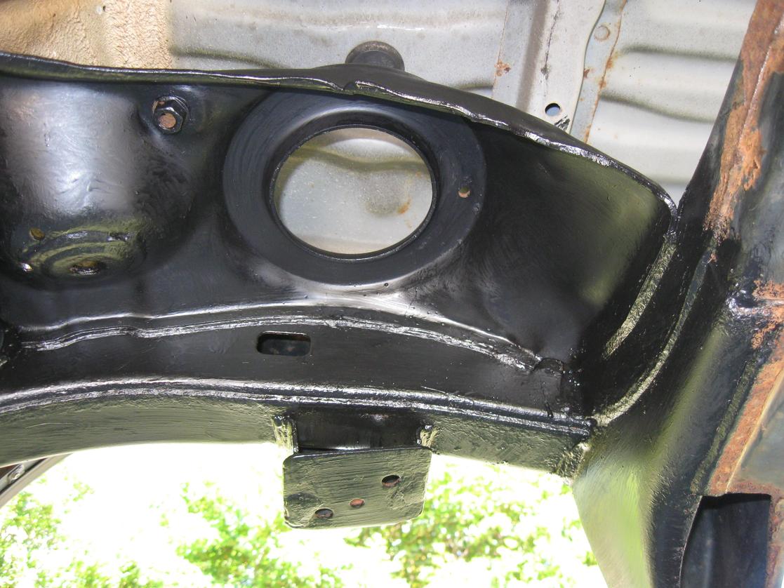

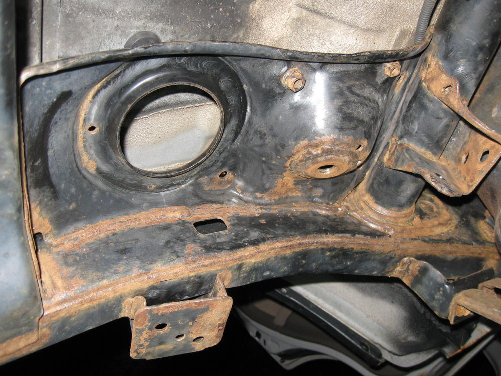

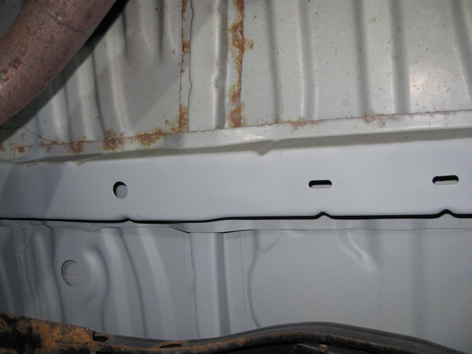

I spent almost every Sat & Sun from July to Nov last year working on my undercarriage. I dont have many pics on my work IMac, all of my pics are my home desktop. But here are a few attachments.

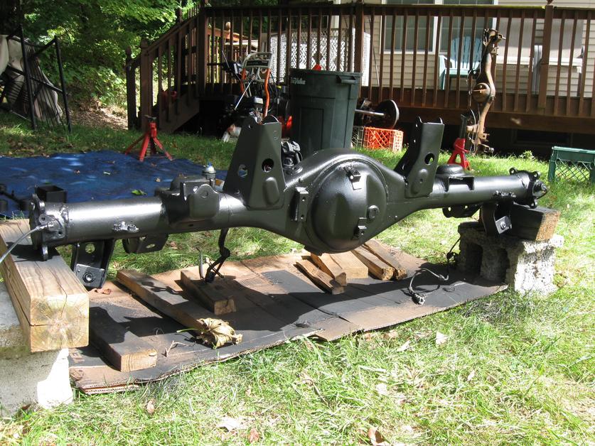

I started with an e-locker axle swap but the rust was so bad (or starting to get bad) that I figured it would be easier with the axle, springs, shocks etc all out of the way.
The new axle, frame rails & cross members have 2 coats of Black Eastwood Encapsulator & 2 coats of Black VHT roll bar & chasis paint.
The body (under side of the floor boards) was pressured washed, decreased by hand, wire wheeled & sprayed with 2 coats of Grey Eastwood Rust encapsulator. Not sure if I'm gonna top coat it. Trucks been in my garage all winter, since Nov & has seen no salt.

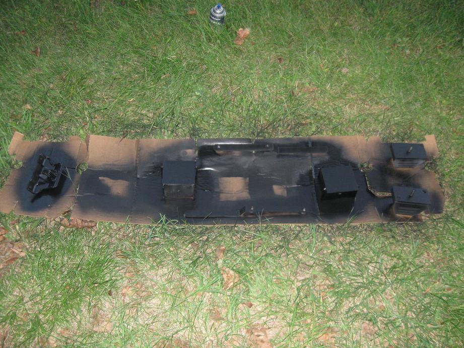

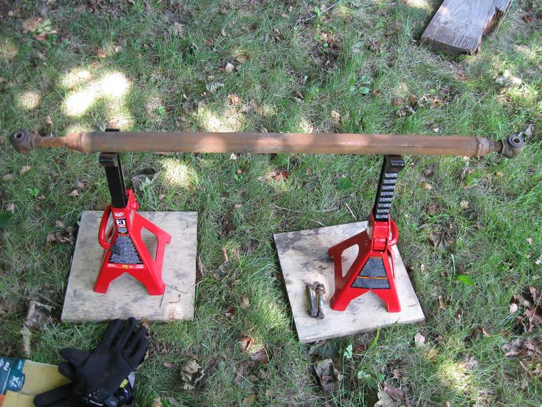

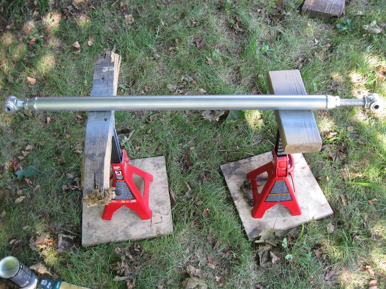

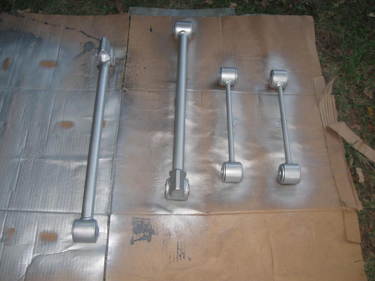

I sanded, encapsulated & painted everything while they were out, bump stops, Upper & lower control arms, pan hard...etc

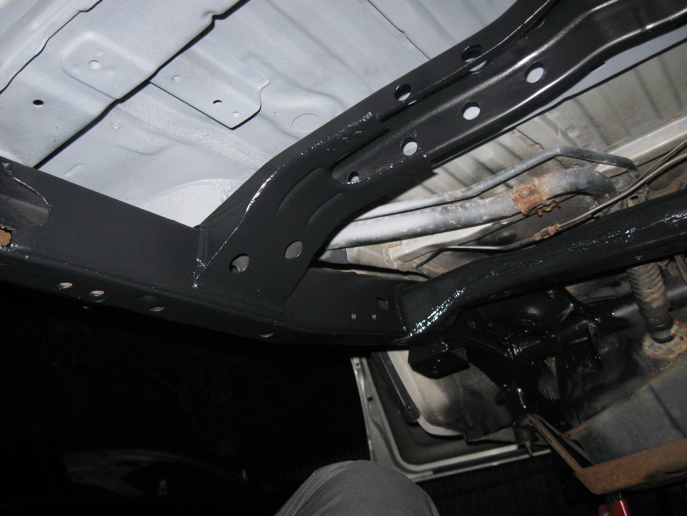

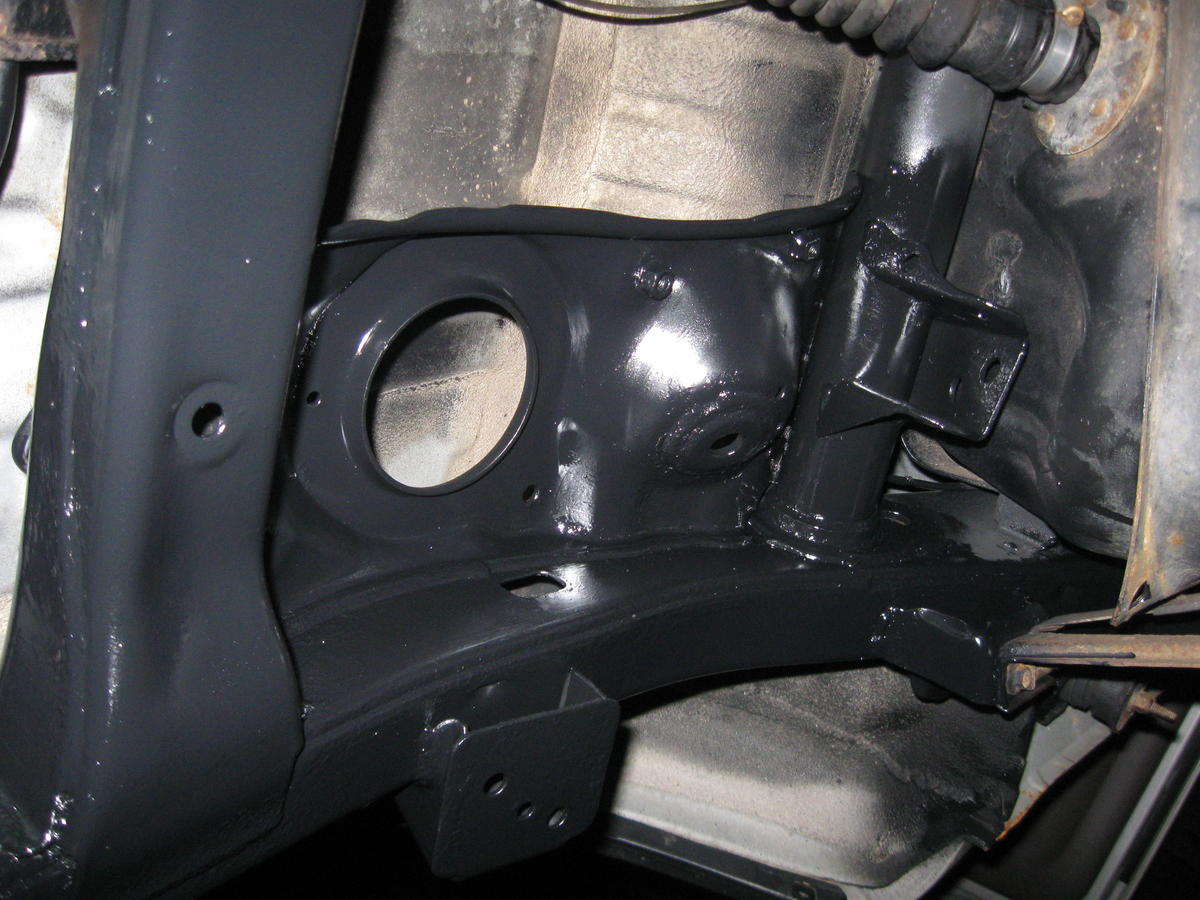

Here's a few shot's of sections that are done. I've only completed from the LCA mounts back. It's a lot of work & I understand not many people have the emotional attachment I have to mine.

Nicely done.

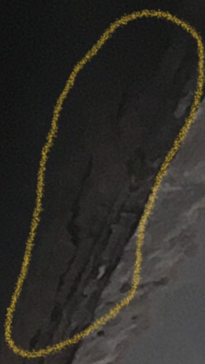

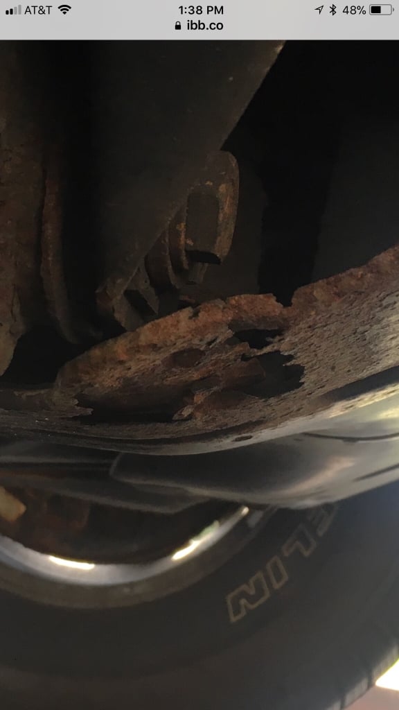

Let me start by saying that without any of us actually being able to see the frame rust in person it is impossible to judge the severity of the damage. I am all for taking a wire wheel, grinder or whatever you want to it and apply you choice of rust inhibitors to any and all SURFACE rust...however in a few of these photos it is most definitely not surface rust, it is rusted from the inside out and far worse than what can be seen from the outside. In the picture I circled an area that looks like you could push a screwdriver through... that metal was thick at one time but has now lost all it’s structural integrity.
That’s not surface rust.
