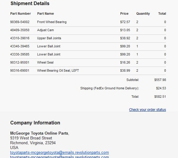

My original front bearings and ball joints have 360K+ miles on them (still tight), but I figured I'd tackle these now. I just put in an order yesterday with Mcgeorge Toyota. I put in a new OEM steering rack with tie rods a couple months ago. This should push me over the 700K mark.
