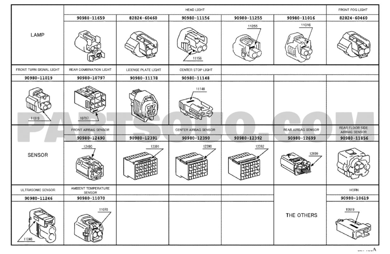

Here is what I found using my VIN on partsouq.com
I've never seen another site offering schematics as detailed as these. Much more detailed than the generic ones found on dealers websites.
https://trdshop.carlocktoyotaoftupelo.com/oem-parts/toyota-connector-wiring-ha-8282460460
https://www.amazon.com/Genuine-Toyota-82824-60460-Harness-Connector/dp/B00G0OZEUG
