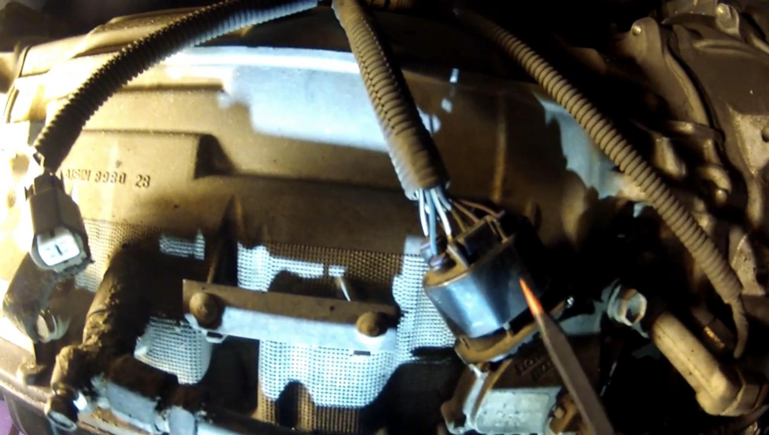

2001 4wd. I just paid a shop to do a rear main seal (mistake) and they broke the PRNDL switch connector on the passenger side of the transmission. I think I found the pigtail for the harness 90980-11784, but I can’t find the part number for the switch itself that bolts into the side of the transmission and don’t have access to a FSM.

I don’t think so, it’s this thing (thanks to Timmay for making videos so I don’t have to go out to the garage to get a pic lol)
That's the neutral safety switch... You can find the connector by itself from various vendors that do wiring for motor swaps, etc. (it matches some years of Supra, so it is well supported)

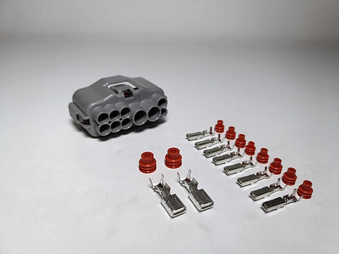

This one is from kaizen fab:
PRNDL connector (confirm it matches the prndl plug)

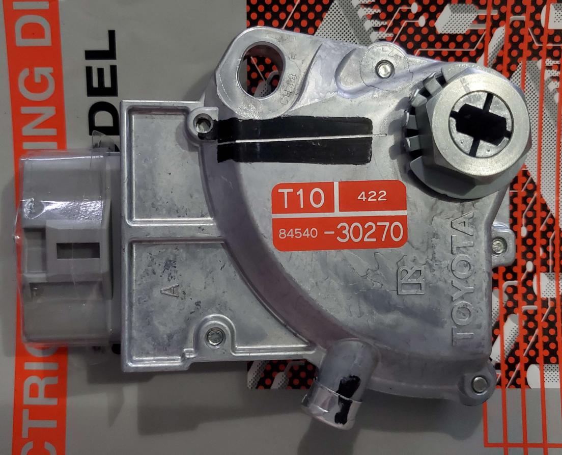

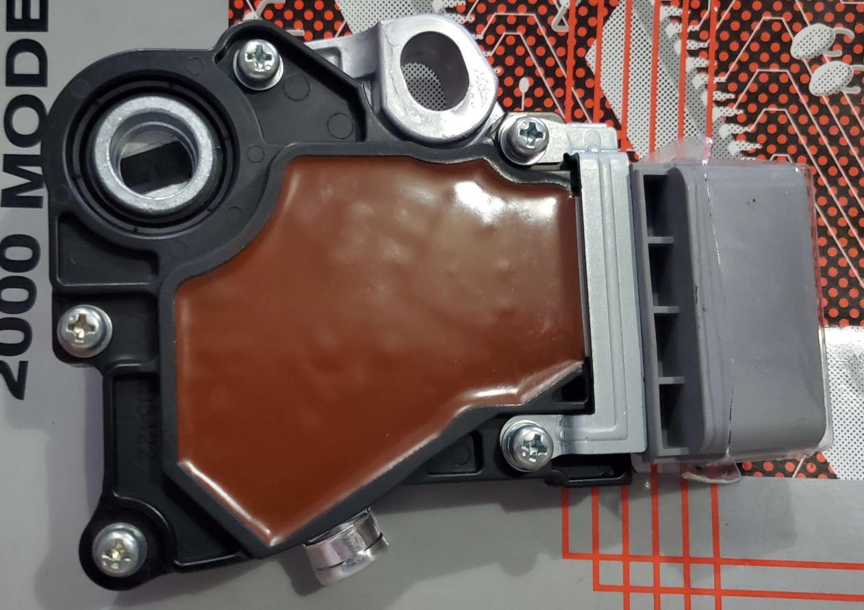

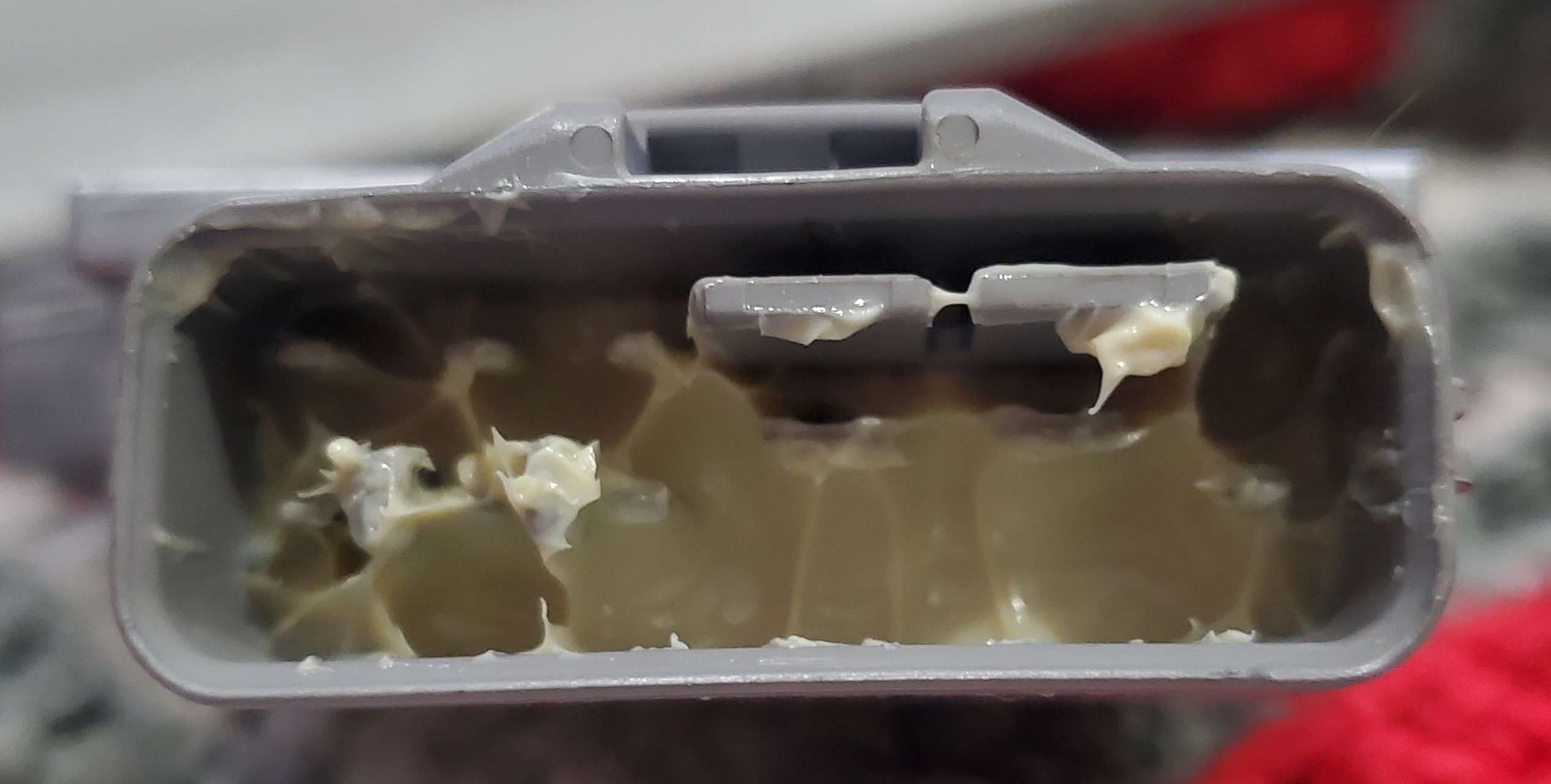

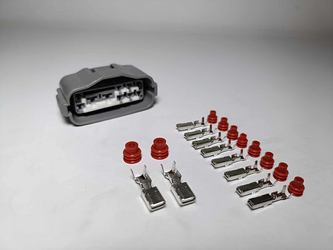

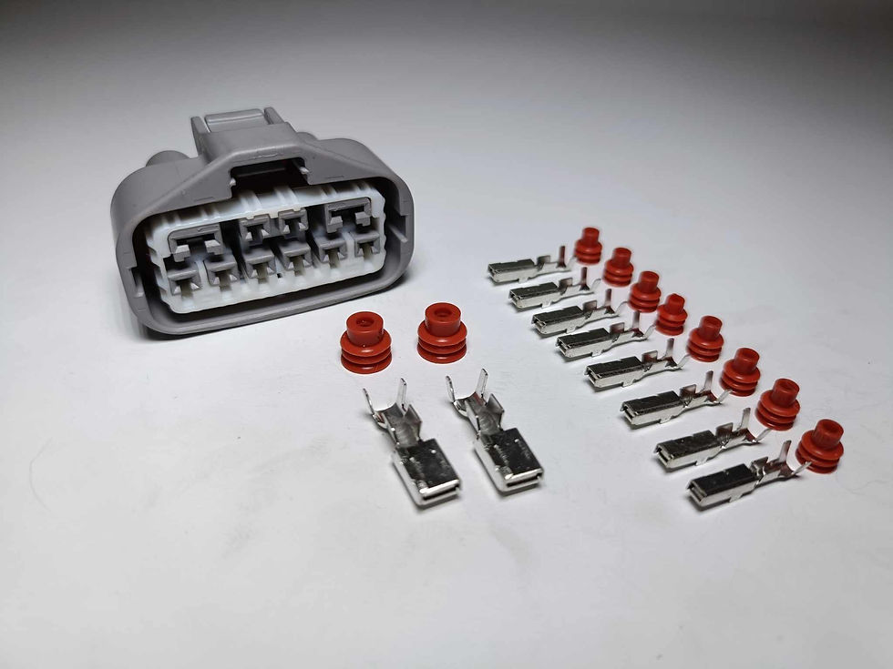

I have a new 84540-30270 neutral switch sitting in front of my now (for my 2000). After looking at the plug this connecter looks like it.
Connector
But I'm assuming kaizen is not in the US.

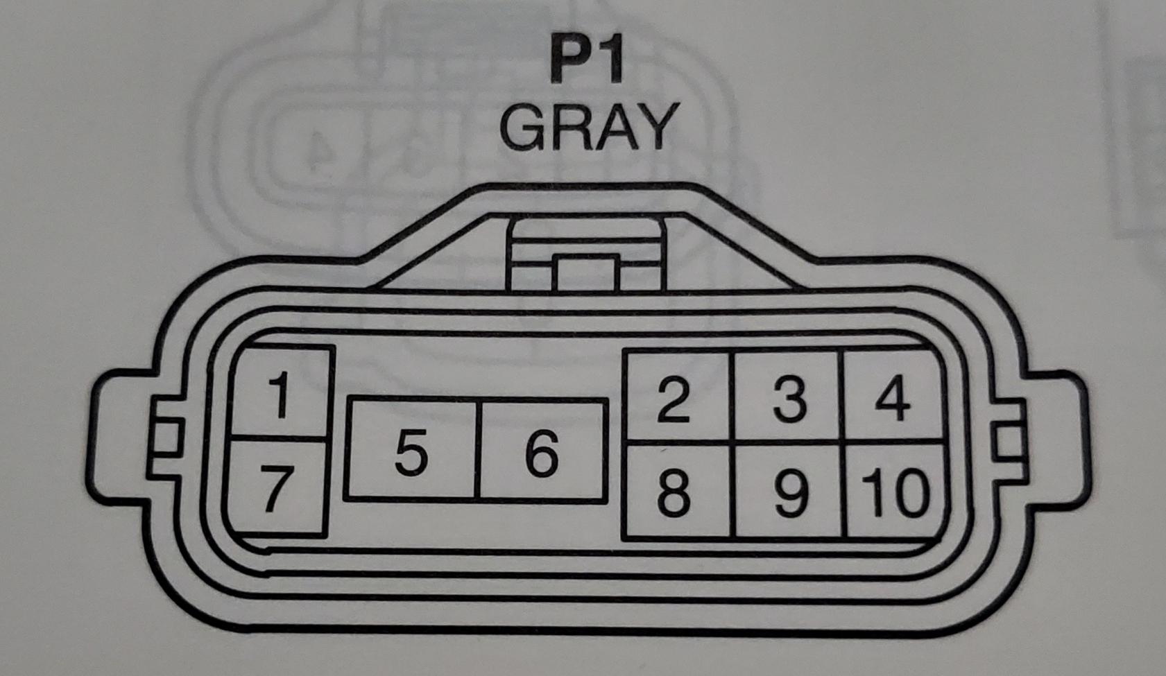

Adding this. Forgot I have a 2000 wiring diagram. The neutral switch connector is labeled P1. I looked in the back for part # of connector and came up with 90980-11332
Toyota parts deal
Can't confirm if it fits a 01, but looks like my connector for my 00.
Pic from the wiring diagram.
Edit added pics of my 84540-30270
