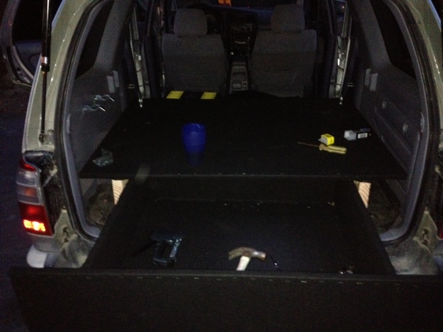

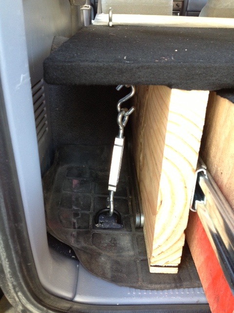

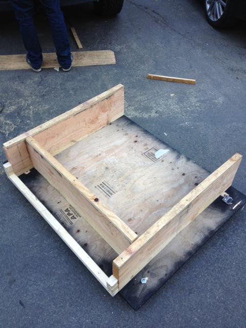

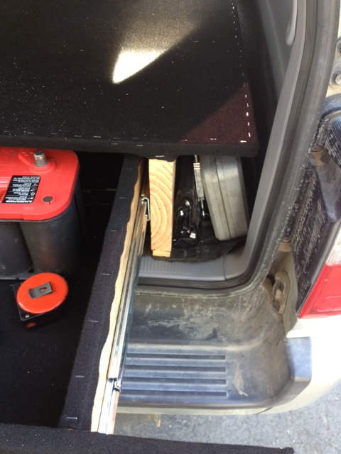

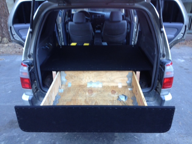

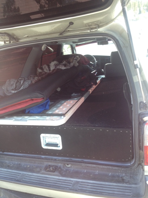

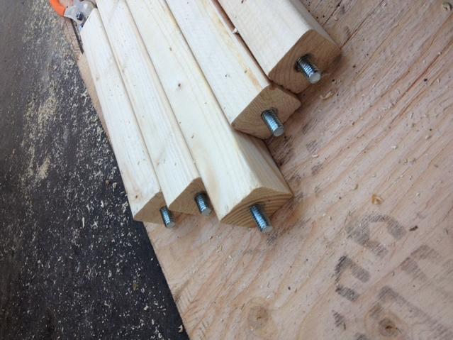

I have built what I think is the pefect sleeping platform and cargo area. The extra piece is hinged, and very sturdy and comes in and out within minutes. The legs unscrew and I bolt the other side down with a long bolt and wing nut that screws into a 2x2 that the front portion of the platform can sit on. The cargo area was incredibly easy actually. Just pick up two 2x10 pieces of wood and a piece of 3/4" plywood. Most 2x10's are not actually 10", which is the heighth you need to clear the wheel wells on both sides. Cut your 48" wide piece of plywood to the length you want and drill it down to the 2x10's. You now have room underneath and can add a drawer very easily. I hope these pictures help.

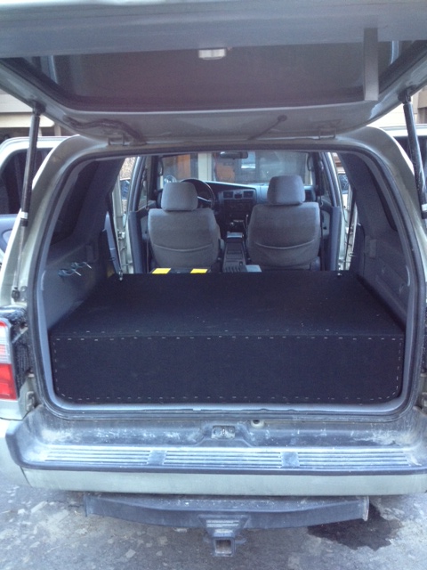

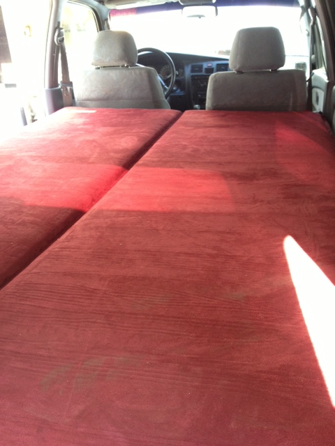

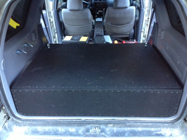

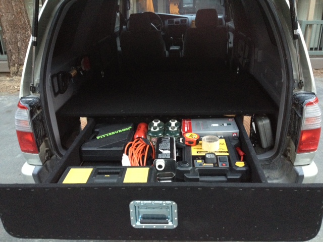

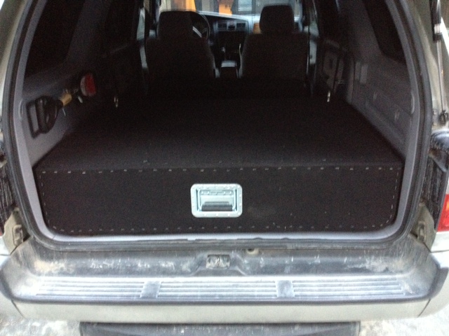

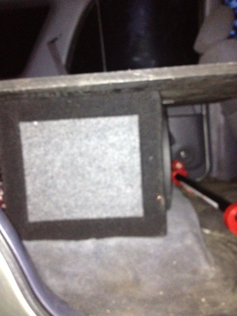

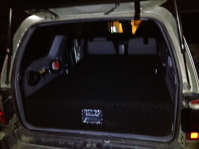

Here are the rest of the pictures of it mostly finished. I will try and get better pictures later and actually add it to my build thread or start a new thread because I know many people on here are interested to do this! When I take the seats out I can put my sub box underneath the platform (it fits literally perfect) and adds a lot of extra support.

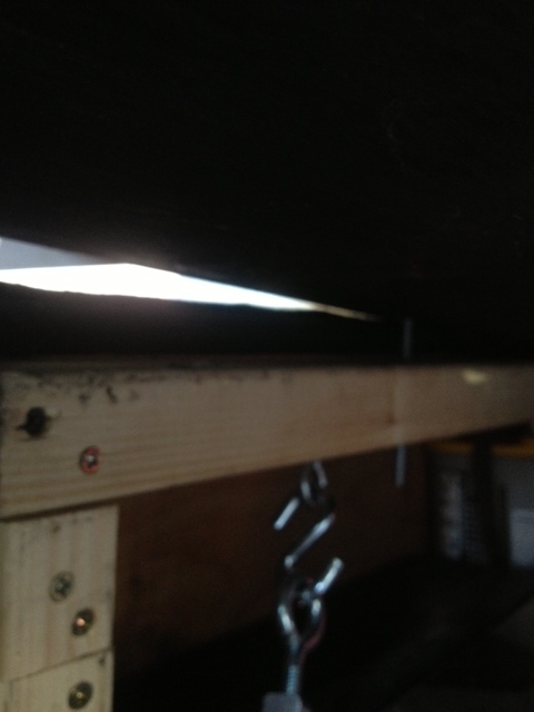

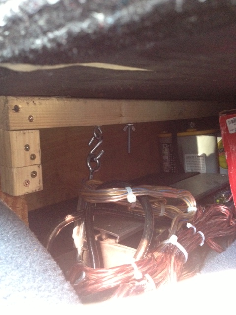

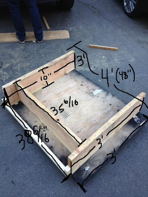

My sleeping platform is currently all setup so it is hard to take pictures, but, if you look at the third picture I posted the farthest left piece of wood is a 2x2. I drilled that to the back of the cargo box 3/4 inch lower than the top. That is where the front piece sits. In the fourth picture although very blurry you can see I tried to lift up the front piece to show you how it sits. I then drilled a hole through the front piece and the 2x2 and I put a 3" bolt through it and secure that with a wing nut so the two pieces are now connected and will not move.
I will try and get exact dimensions as soon as possible. For the front, just cut the piece in half and put door hinges on the bottom. Works perfect! I will try and get you better pictures as soon as I put the seats back in.
this might help if you can understand what you are looking at. You can see where the bolt goes through the top part and the 2x2 it sits on and then is secured with the wing nut on each side.

Ok, I took some measurements!
(1) 3/4" Plywood- 36" x 48" (For top piece)
(2) 2"x10" that are cut to 36" long (Next to wheel wells)
(1) 2"x10" cut to 35 6/16" (for in between the other two pieces for added support)
(1) 2"x2" piece cut to 38 6/16" (for front piece to rest on when connecting the front portion for sleeping area.
If you want to make a drawer you will need to finish all of this first and then once you order drawer sliders take measurements to make the drawer whatever size you would like it.
For the front piece, it is just a piece of 3/4" ply that is cut to 48" wide and 38" long. Cut in half so you have two pieces that are now 24" x 38". Drill a hole in each piece as well as the 2x2 that this will rest on and secure it together with whatever kind of bolt you would like. I used a wing nut so I could take it out in seconds. For the front I made two legs that screw in and out so when I fold the front piece up I can store the legs as well. I will post up better pictures of everything when I can but I hope this helps!

One question though. You mentioned you have the seat bottoms out of the truck, are you able to use your system w/o removing them? I was really hoping so on my build so I could use it with out much planning (ie. crashing after drinking, impromptu camping and the like). Just fold the seats down flip it out, maybe clip on one more piece for length thats stored between the box and seat back and be good to go.
