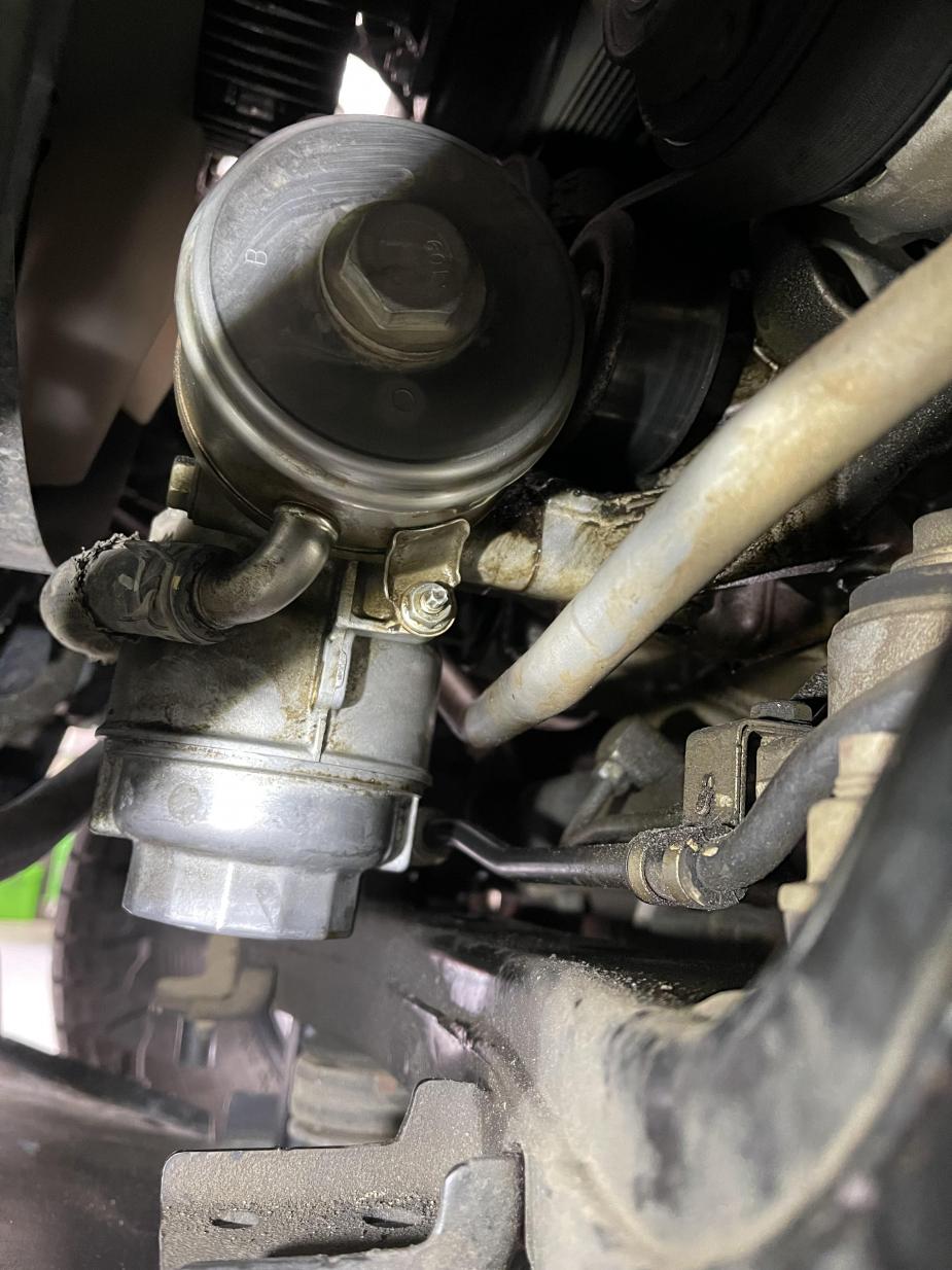

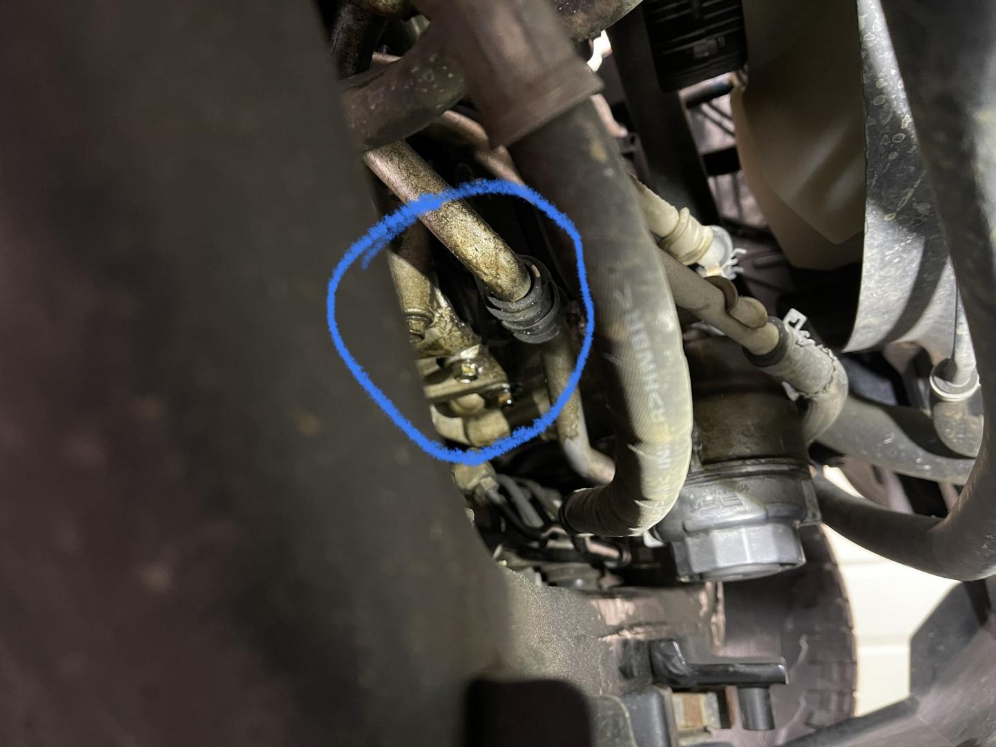

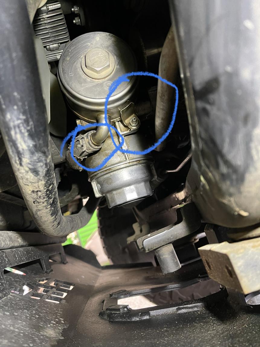

Hey guys/gals, looking for some help here. So, for my last oil change I changed out the filter housing to a metal one which is the only real thing that has changed and I watched it for a few days afterwards and no leaks. I glanced at some of my skid plates today and it looked like I had some oil on them. My first thought was that new housing but the leak seems to be coming from something higher. I am guessing this is the oil pump?
Has anyone seen this before? Could the new housing be causing an issue? I will probably take this to the dealer but just trying to do a bit of research first.

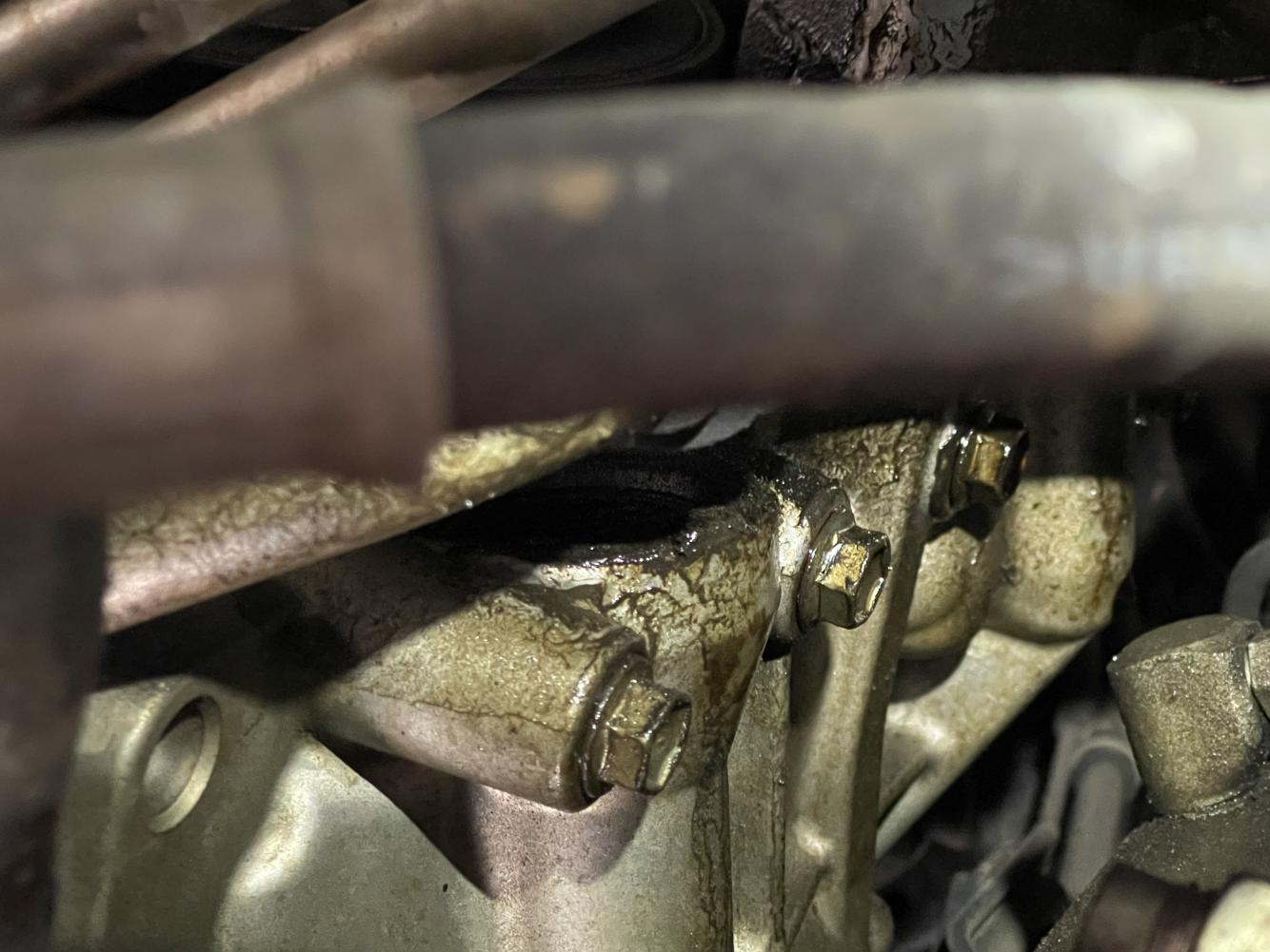

I have verified that it is not coming from anywhere around the top of the motor, it all seems to be clustered in that oil filter area but above the housing and seems to be pooling on some of the bolts picture below. Nothing has been done to the motor as far as repairs or modifications go.

It's the gasket between the oil filter housing and oil pump. The airflow in that location blows the oil all over the place, even higher than where it leaks.
Did you replace the gasket when you replaced the oil filter housing? Check torque. Did you use Toyota parts? If still in doubt, swap parts back. Front main seal leak is highly unlikely. Last thing you touched is always most likely.

Yeah, this crossed my mind as well with how much airflow is in that location. Yes, I replaced the gasket but I did not use the OEM Toyota part on the housing (and I know better). I am due for another oil change so I am ordering those parts today. Thanks Jeremy!
