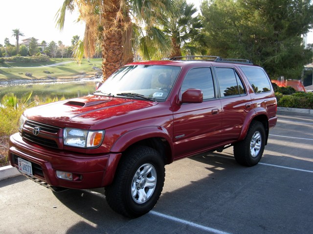

Hello,
New to the forum (this one anyway) and wanted to say hello and ask for some advice from personal experience.
We just picked up an 2002 4X4 Sport Edition 4Runner last weekend for $8900.
Pics below
It has 123k on it with stock springs and shocks......Bottom line....
It rides like Fred Flintstones car.......(as I can imagine Fred's car)
The stock shocks are DONE!
This is my wife's daily vehicle so I'm not necessarily looking for a lift but mostly trying to achieve a better ride for us. It does have 1 size bigger tires on it already so a small 1.75 to 2 inch lift would be alright.
I do have a 05 Tundra 4X4 with Donahoes, Alcan rear leafs and Bilstiens so I'm not new to lifts, but I'm not looking to put that much money into the 4Runner lift.
We won't be wheeling it other than fire roads, mostly daily driving.
I've researched OME, Toytec, and Sonora Steel, so far, all seem to have pluses and minuses. Mostly cost versus what your going to do with the application every day.
At the moment I'm leaning towards OME 880 front coils with shocks and 906 rear coils with shocks. Toyota of Dallas has them for $675 plus shipping.
Any personal first hand opinions/experience would be welcome?
Thanks for the time,
Rob

Awesome truck. That looks to be in great shape so it sounds like you got a very good deal.
Sorry I don't have any advice on the lift. I am trying hard not to go down that route!
