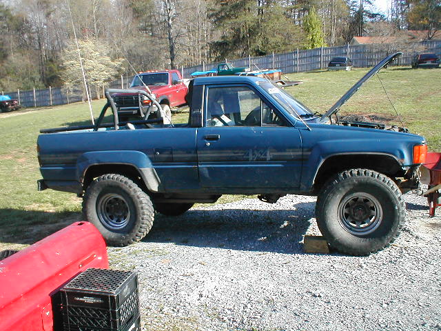

everyone has an opinion, this ones mine. The absolute best yr runner is the '85 with EFI. You get the best of both worlds, its the last yr of solid axle fronts, and first yr of fuel injection.mines an '86 and i love it. about to do a solid axle conversion but other then that it is a heck of a machine. check her out its 4runner of the month for april, also just rebuilt the engine and yes the 4 cyl are bullet proof, i put that thing through hell and back and now its been revived even stronger, pushes 35x12.50 tires easily. and with the 1st gen runners they have the romavble top awesome for the trail on a beautiful day, hope this helps, if you have any questions email at [email protected]
I agree with Hammerhead06 to a point the Solid front axle is the way to go but finding one at a good price in good shape is hard most know what they have and you will pay.
