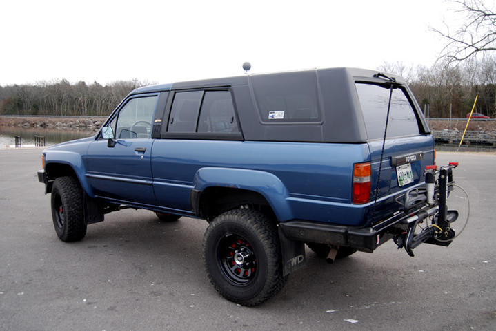

My FT2900r is mounted to an aluminum plate I made that uses the factory mounting where the map light mounted.
If you need to park in a garage, you may want to mount the antenna on the rear bumper.

I mounted mine to the hump on the center console.
The antenna is mounted to my cargo rack. I use the 1/2 wave whip for when I'm doing my daily driving. For off road I use a 'Fire Stick'. Both use a heavy duty spring.
If you don't mount your antenna to a ground point - be sure and add one.
