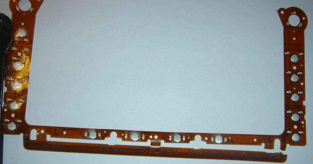

Yeah, that's the beauty of simply replacing the ribbon cable piece. The ribbon cable piece goes all the way around the screen. And all the LEDs are mounted to it so no soldering is even required! I'm an experienced solderer with a nice solder station, and after taking the faceplate apart and seeing how much would have to be done, I quickly lost my mojo and decided there was no way I was gonna desolder then resolder all that LOL!
The price for the piece for the E7007 is $78. It is definitely worth $78 for that headache to go away but the part number is obviously different for the E7008 as the LEDs will be amber.

Actually, I went back and checked, it was a post by member FAydin (http://www.toyota-4runner.org/audio-electronics/26558-ruined-toyota-nav.html), and the price was $68. Now that was for his E7007, but I can't imagine the E7008 part would be a different price, or much higher if any. From United Radio Service & they would need the part number from the E7008 unit.
I've included the pic from the original post (If anyone has a prob with me using FAydin's pic let me know and I will remove it) to show what exactly is going to be replaced. His ribbon got torn so it needed to be repaired, but found out it could be replaced, which started this frenzy.
Again, just need someone with an E7008 to post the part number or take a pic of the label for everybody.
