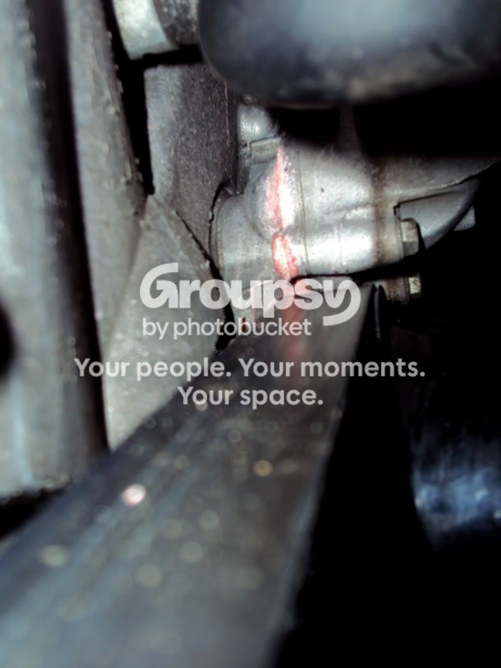

Apologies for taking so long. My camera was MIA. :bash:
waterinlet.jpg~original
Here is the photo. what your looking at is where the leak I have found on my truck. It seems to be leaking really slowly, this build up is after around 3-4weeks.
Above the serpentine belt is where the inlet is, i had to tuck the camera around from a radiator hose and the water inlet to get the photo. There does not appear to be any coolant leaks from the pump.
Please tell me if anyone else has encountered this same issue, if so, is the leak from the water inlet?
What is the correct procedure on changing the O-ring if this is the issue?
THANKS

so after more observance, I pushed some of the crust out of the way to see the seal on the water inlet. the seal and he connection between the engine are tight with no leaks. Looks like the leak is spraying up, probably from the water pumo leak hole on the top... As the Chilton guide has stated " Time for a new pump...."
