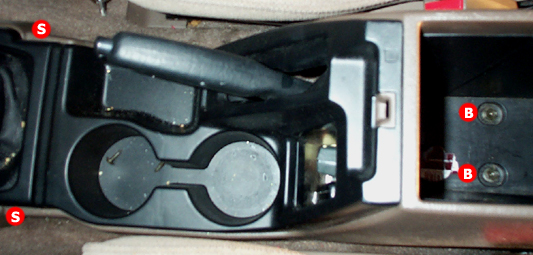

the center console on my 99 limited is loose. I can tell it is the part from the ebrake back that is loose. Does anyone have a diagram or pictures of where all of the screws/bolts are that keep it tight?
lucky, i just did this last night, the ebrake will not make this loose. the center console has 2 10mm bolts in the console at the bottom, and it has 2 screws on the sides where the center console meets the shifter section.
the pic is from 4runners.org
also the 2 side screws
verify the front side screws on both passenger and driver side also tight.
Not the back screws obscured by the seat- don't mess with those unless you take the whole console out for cleaning or whatever....
