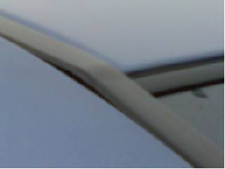

Hey folks, I did a few searches on here and yotatech yesterday and didn't find much, so I'm going to bring this one up. I have some exterior rubber trim coming loose on both sides of the windshield trim piece. The pieces that are coming loose are the runners from the roof rack to the bottom of the windshield. I'm wondering if this is normal. I'm still under warranty but I don't want to have to drive to Sioux Falls Toyota dealership if there is an easy fix I can do myself. I will try to post photos but I'm guessing that others have this issue. I don't have a digi camera but can get one if you all really need to see the pics to compare to your own problems. Thanks and belated happy St. Patrick's day! :beer:

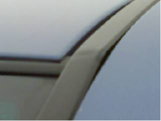

Well, I just got off the phone with Billion Toyota in Sioux Falls, SD. They said there is no TSB for '05's, that they were produced after the bad part was taken care of on the TSB. Well, I don't see it that way. I sent him pictures, will leave work early on Friday (:beer: (j/k)) and go down there and have 'er fixed, although I'm not sure if they will glue the current problem or replace it. Only time and annoying stealership visits will tell!
Mine is identical to the pics. Let us know what they do.
