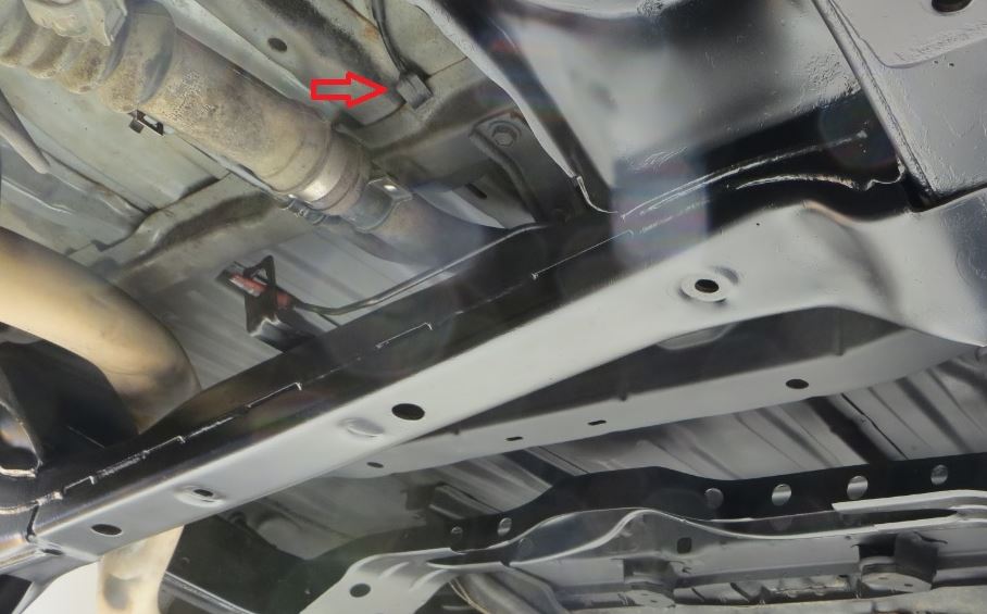

I saw this while I was doing my BL today. I can't tell where it goes or if it ever went somewhere. If it was always loose I can't imagine why I've never seen it before.
Any ideas where it should go?

Could that possibly be the fuel overflow drain tube. Like when you spill fuel while filling up in the compartment and there's that little drain hole. Maybe that tube connected to a fitting near the fuel fill pipe.
Tracing it out, it appears to be coming from my E-Locker... Same as those wires it's running with.
Does it go anywhere, or just sit up there like that?
One end goes to elocker, the other end goes to this clip shown below (its roughly in the vicinity above the rear brake hard line). If you have extended your diff breather, now would be a good time to extend this breather also.

Excellent, Thanks! I'll get under there tomorrow and look. I'm sure I pulled it loose when I went up to Crown Point Mine. I did some major flexing turning around on the trail. Actually had a family applauding when I finished! LOL
Already extending the diff breather. I didn't even know this one existed.
Yep, that's it. I found that little "clip". It looks like it just tucked up there... So I'll be adding to it and routing it with my diff breather. Will be easy and clean.
