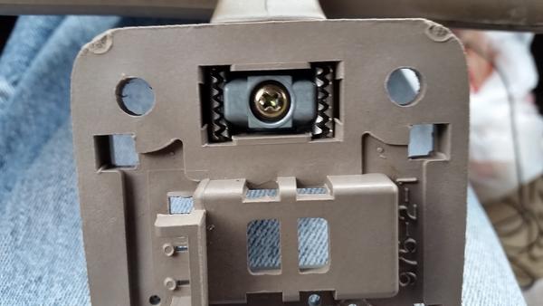

4th step - now you should have this :
carefully remove that last screw, the mirror will separate from the mounting base. When the screw comes out, there's a small cast pot metal piece and 2 roll pins that will fall out of a pocket. These are the roll pins that you will refurbish and make the mirror tight again.

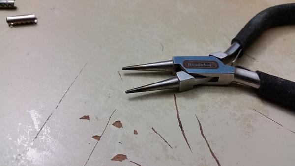

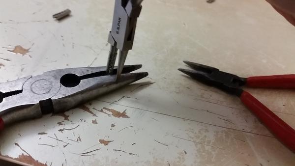

6th step. I use my taper point pliers to spread open the roll pins again. I do one end, then flip the pin and do the other end so that they are reasonably spread open an equal amount.
I just gently tap down on the pliers until they spread open, then flip the pin and do the other end the same way.

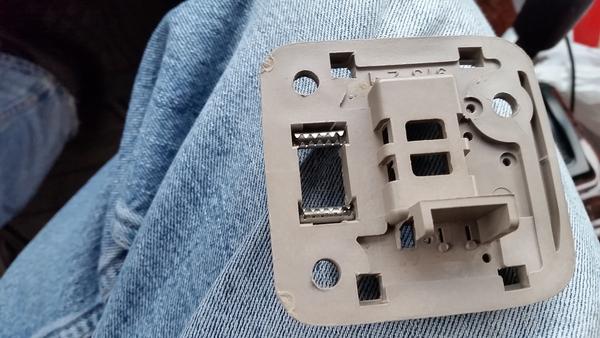

7th step the pins have a notch in them, so they will only correctly fit one way in the mounting base.
