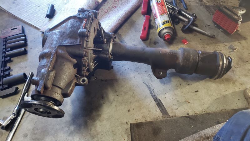

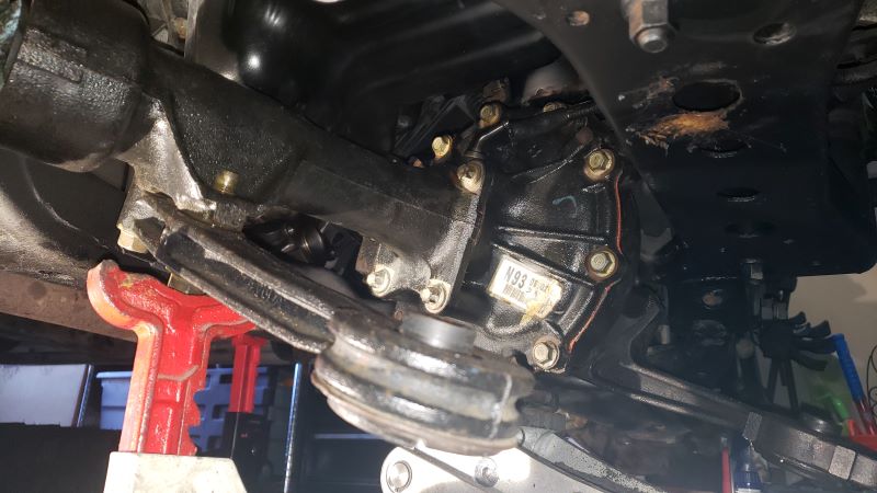

Old one is out. One CV would not pop out though.
Replacement one is partially in; I am having a hard time getting the breather tube bracket bolted back on. Any one with suggestions on that?

Going it for it eh? Congrats, looking good! Looks like both CVs are out, just the intermediate shaft? (nm I see boot now, couldn't zoom on phone) If no one who's replaced one of these comes along, might describe what issue you're having with breather tube, and pic would help. Just can't get to a bolt?
