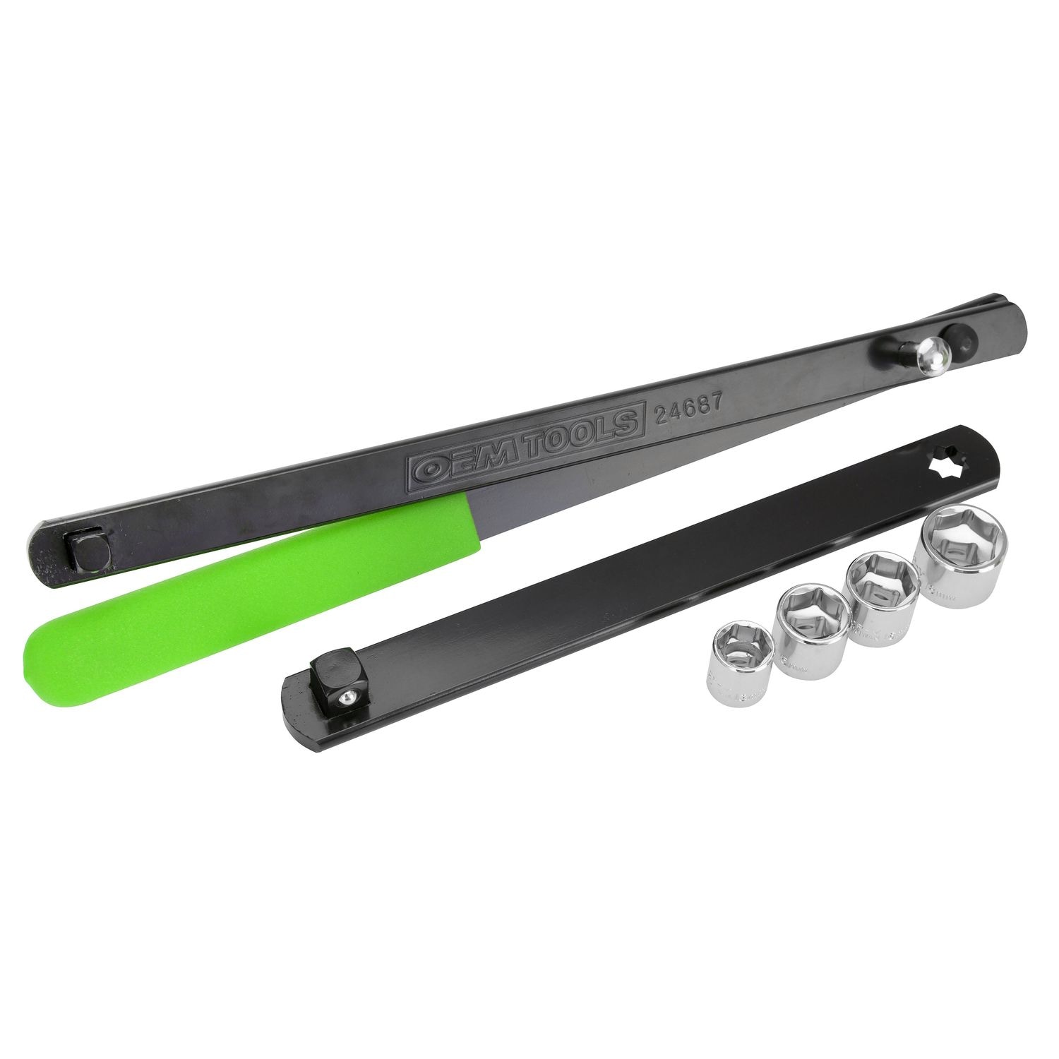

Just buy a serpentine belt tool:
$30 on amazon. It's worth it. Good for other random tasks as well.

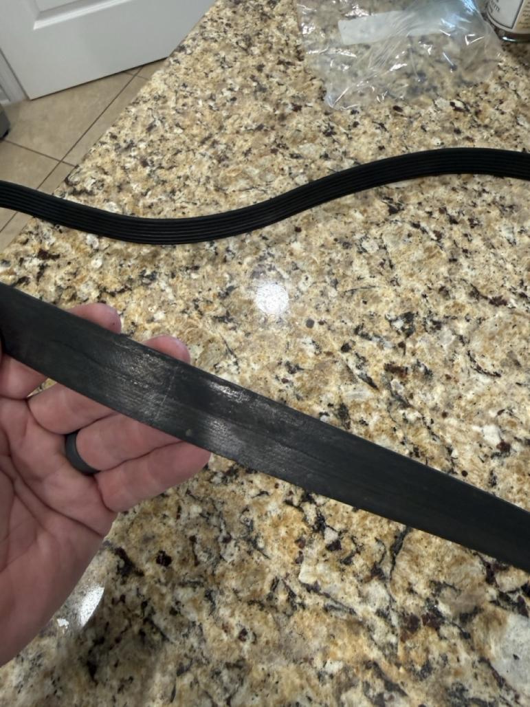

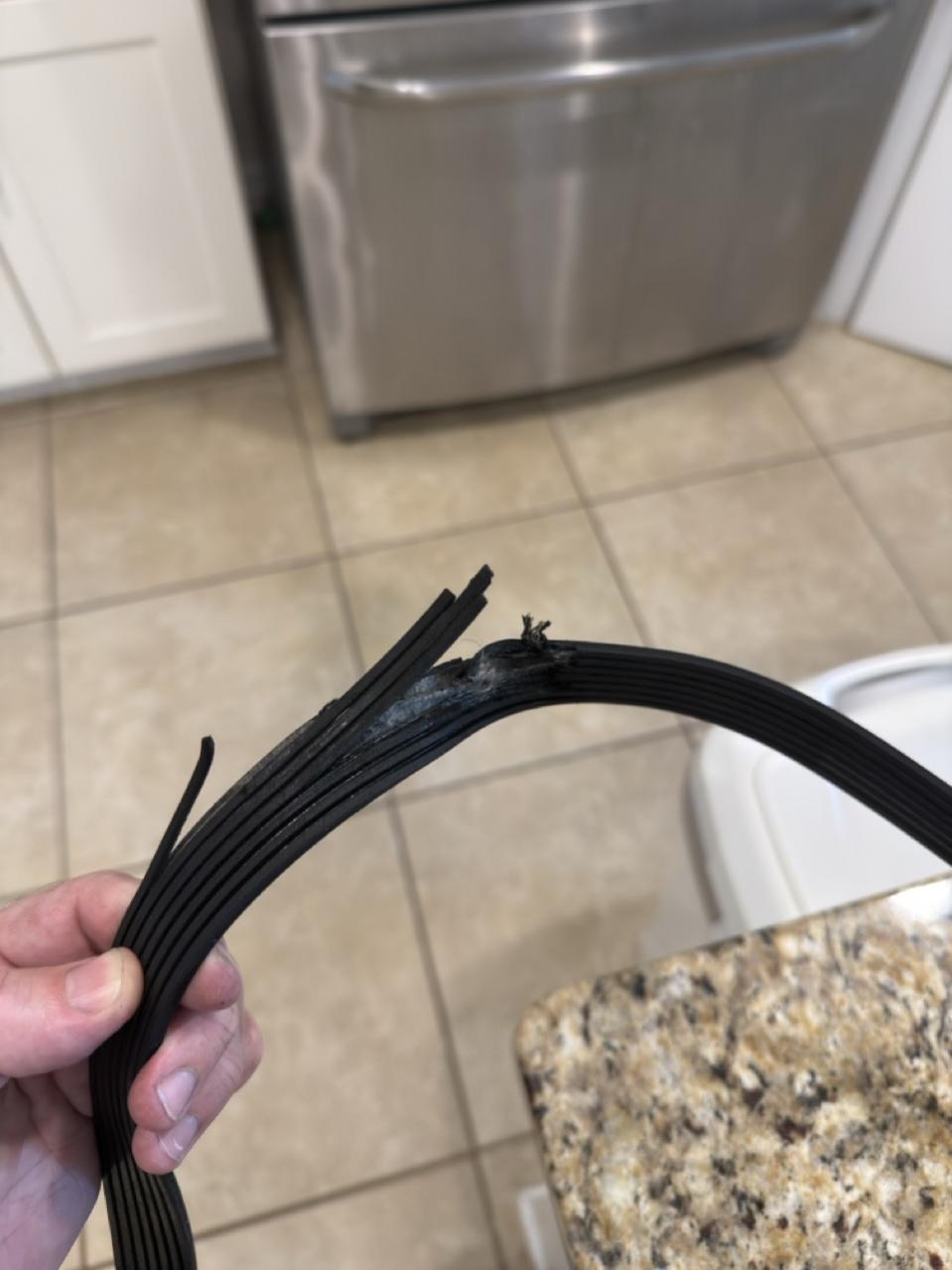

Well, back from a wedding and dove into fixing the problem.
Here’s where the loud racket was coming from.
Pulleys do seem like they need to just be replaced so I will do that. The idler pulleys and tensioner pulleys all seem to be spinning more freely than they should and a few make a little noise when spinning.
I replaced the alternator and put on a fresh belt around maybe 200 miles ago and this happened after I did that work. I have had some pre mature belt wear in the past, but nothing like this. This happened after the alternator replacement. Question here is how would this catastrophic wear happen so quickly? Is the alternator not seated correctly? Incorrect belt routing? Just a bad belt from the store? I want to make sure I find the culprit so this doesn’t happen again.
