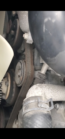

With better lighting the "new belt" looks awful. What's even more worrying is that one of the wheels is disintegrating and flinging rust dust everywhere.

I don't know exactly when it was last replaced, I have an estimate. I don't see any sticker anywhere best guess is before I got it about 6 months ago.
Sent from my SM-G973U using Tapatalk
How old is that belt supposed to be? It is possible that it's a new belt.
I've seen some horribly rusted vehicles just ruin new belts rather quick. I've also seen the drive belt tensioner start failing and cause misalignment of the belt and wear them out pretty fast as well.
How do all the pulleys look, they have a lot of pitting and rust on them? The tensioner pulley should be relatively in line with all the other pulleys.
It could be 6MO or 10 years old I just don't know. But again previous owners don't know what was done to the car when it was brought in to get the front end worked on. The assumption is that yes it is new, because the past owners said that it was "last changed when it needed to be"

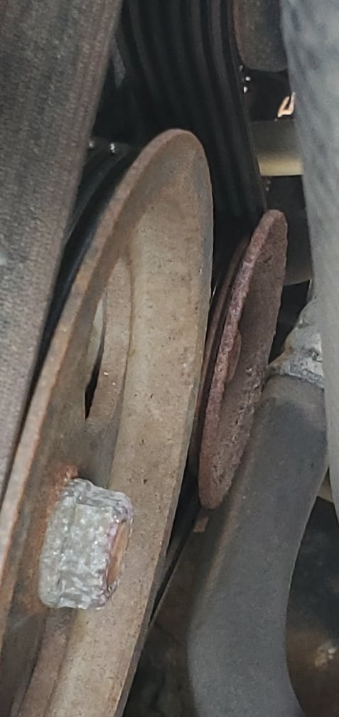

Pulleys are in okay shape. Except for two on the bottom left which are rusted to the point it's flinging rust on the hose below it. It feels taught, and the teeth are there.

Oh. My. God.
So. That belt is not new. Previous owners went through service records. (They found them!)
This belt may well be the original with 187,000 miles on it. That explains the lack of any stickers about replacement as it's never been replaced.

For the whine, I would buy a new belt, and while it's off spin and feel the pulleys. Any gritty feeling, noise, or anything that feels odd should be replaced. Does the noise change when the AC is on/off? Look at the belt too, in the video it sounded like someone said it's fraying, that could be slapping something as it goes around.

Just an FYI, the belt you're referring too is the serpentine belt, I have never seen a sticker for the serpentine belt being replaced nor a sticker coming with a new serpentine belt to be place in the engine compartment, now on the other hand the "Timing belt" should always come with a sticker showing when it was replaced.
A serpentine belt is not as critical as the timing belt, if a serpentine belt breaks it will not usually damage much else for the most part unless it runs the water pump in which case you should shut down the engine until it's replaced, but if the timing belt breaks on many engines it will destroy the engine which is the case on the 4runner V8.
That being said if you don't see a recent sticker for the timing belt (should be replaced every 90,000 miles) or have a record of it being replaced I would be very concerned and get it replaced.

This, what he said. Your not looking at the timing belt there, it's definitely the serpentine belt unless your motor exploded already and we are looking at the inside of it.
Timing belt is at 90k and 180k I believe, thought you said your at 187? Which is exactly where I am milage wise. I wouldn't freak out about it but I would check to see if the timing belt got done at 180, which I doubt honestly. Seems like a lot of times they get sold before the timing belt gets done. I'm getting a belt, water pump and pulleys to fix that but the ticking I have is exhaust manifold. I was thinking about pulling them and welding them but it's not worth it. Hopefully we can still get Thorley headers, if not it's original equipment or make your own set. The rest of the exhaust system I'm not sure who makes what anymore but a custom exhaust shouldn't be too expensive to have bent up. Just have to get a couple of little bullet style cats to fit in.
The whine is more than likely power steering, check the fluid. Clean the goo out of the pump and reservoir and it'll probably go away, after cleaning mine got quieter and my buddies got quieter.

If you are at 187,000 and have never had the timing belt replaced you are inches away from disaster. The V8 in those years of 4Runner is an interference engine. That means that for better performance, the valves go into the cylinder when the pistons are not there. The timing belt moves them out of the way when the piston comes to the top of the cylinder. If the timing belt breaks then the valves stay in that area and get smashed by the pistons. That will be a VERY expensive repair and may include replacing the entire engine.
You can go to your closest Toyota service center and they can look up the VIN and tell you if that service has ever been done by Toyota, and any other service that was performed at a Toyota service center. At 187,000 you are due for the second one anyway, might as well open up the wallet. It's an expensive maintenance item. It was about $5K when I had it done about 10 years ago. I'm sure it's considerably higher now, but less than a new or rebuilt engine.
