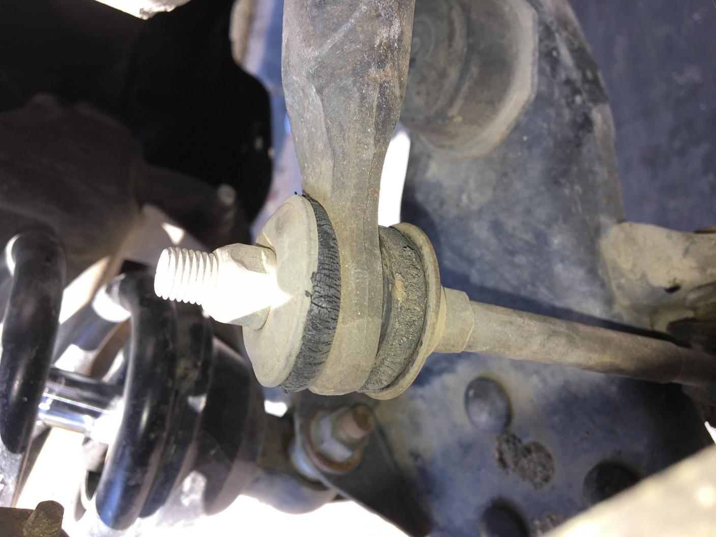

Just recently had icon coil overs installed running about 2.5 inches on front and back right now. Whenever I got over a bump that declines then inclines I get a loud pop noise in on the front left of my suspension. Don’t know what it is
Photo of sway bar end links

I only see a photo of the sway link. The top bushing looks pretty compressed and worn. Can't comment on with upper or lower BJ or tie rod since they aren't in the photo. Did you assemble the coil overs? If so you sure the springs are sitting correct?
I had a shop that build many toyota pre-runners put the icons on for me, so i'm pretty sure they would know to put the springs in the right position.

I just bought 2nd gen 4runner sway bar end links to put on the front, heard that extended one will correct the angle at which they sit because of the lift, hopefully that was the popping noise i'm hearing.
