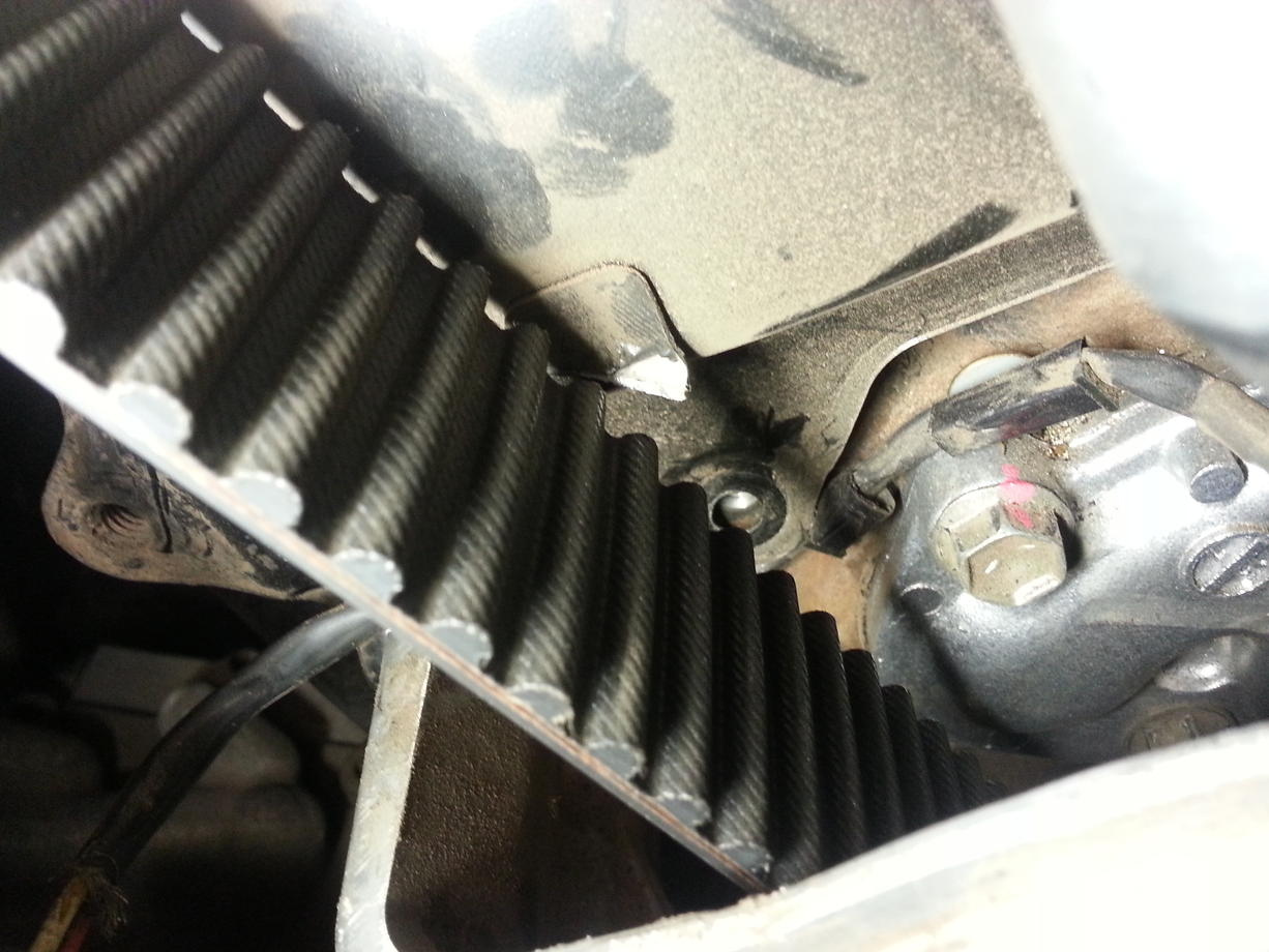

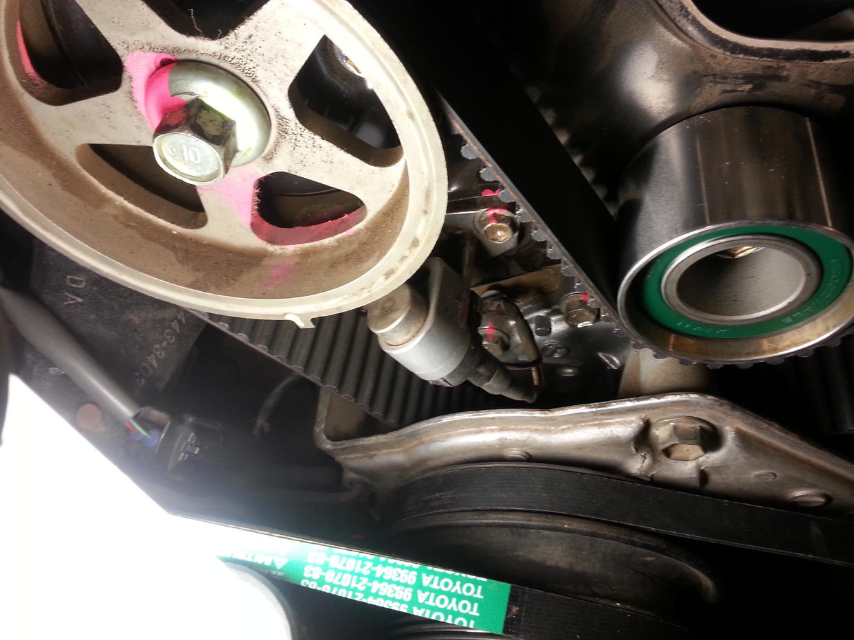

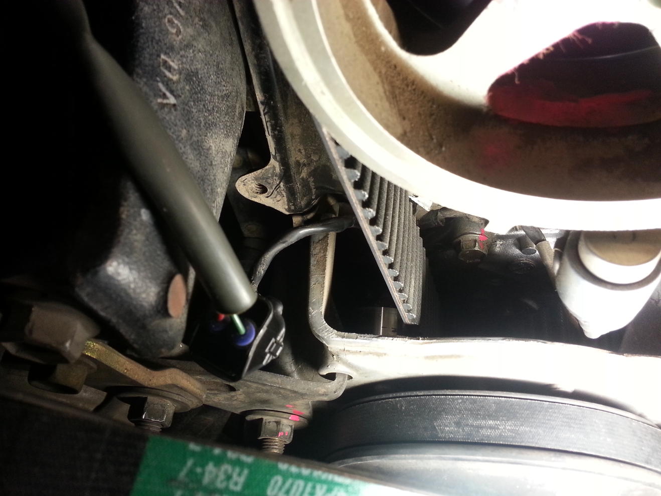

Its very loud on cold startup the last few weeks . Took cover off and all looks good but a couple lose bolts. Any thoughts . Also a pic of a missing bolt where timing position? Wire is. Anyone know what size possibly? Shipping truck to europe on monday and really did not need this issue. Thanks

The squeal is one of your belts. Probably too tight or too loose. Biggest chance is the power steering belt since it is the hardest to reach to get tight. Check the threads on here about tightening your drive belts. Lots of good information is shared. The AC belt and alternator belts are cake. The power steering belt is a little hard to reach the bolt under the PS unit. I would almost bet that belt is loose.
my 2 cents.
Checking those it seems my alt may be a little lose. Does that sensor wire come out at bottom of cover as shown or under the front of cover to the clip. Trying to get this done today if I can. No time left hardly now
