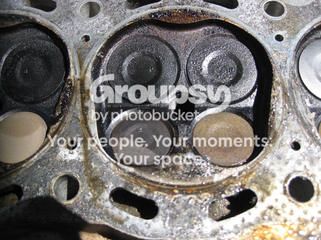

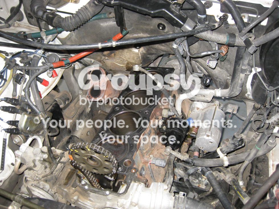

I removed the head and found one of the exhaust valves in cylinder #3 was setting lower into the seat than any of the others. Here are a couple of photos of the work.
IMG_0428_zpsi0awfb2q.jpg~original
This shows cylinder number three, and you can see the exhaust valve (lower left) is sitting lower than it should.
Not sure what caused that, but it doesn't appear burnt to my untrained eye. What do you think caused this?

Another update:
I removed the exhaust valves and the one is burnt bad enough you can see it with the eye. A couple of others are burnt also, but barely. The seats are ok. I am going to replace all the exhaust valves with new and do a valve job myself. I looked and only tool I'm missing is the correct size arbor, so will have to purchase that.
Should save me around $300.
Also, the head is not warped. Amazing how well these engines are built!
