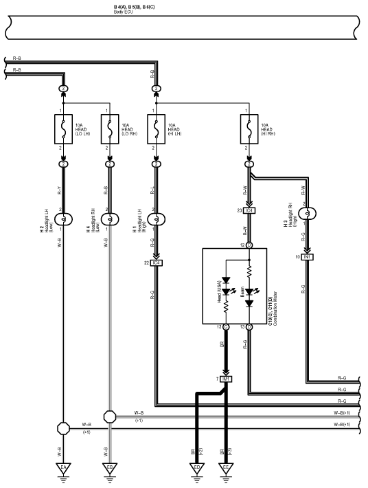

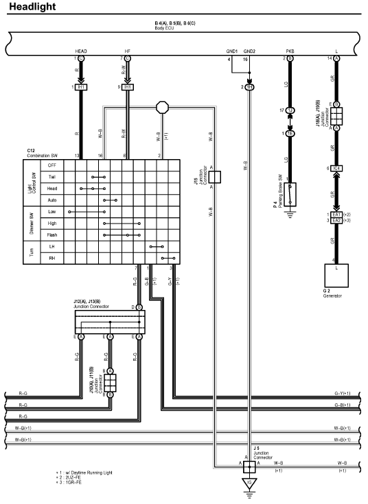

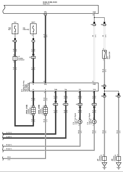

Maybe these would help a little?!
Four different pictures, all of the headlamp system..

cfranck1, that's really helpful. Thanks for the images; every other link I found was expired.
It looks like the one common line for both low beams is the power between the relay and the low beam bulbs. It can't be a ground wire, because the low beams share their grounds with the same-side turn signals, both of which work and it would be weird for both wires to break at the same time, anyway.
I found a post that mentions a "DIMMER" relay, which they say switches between high and low beams. But I believe that conversation was for 3rd gen 4Runners, which I believe uses a single bulb with high and low filaments so wouldn't be applicable to 4th gen and I don't see anything in the wiring diagram that you linked that would be such a relay. Also, a picture of the fuse box online doesn't have anything labeled "DIMMER" so I assume this is a red herring.
Would it be dumb to bridge from the battery to the "output" side of the fuse in the fuse box to rule out a connectivity issue on that side and isolate the issue to be upstream from the fuse?
Thanks,
~Patrick
