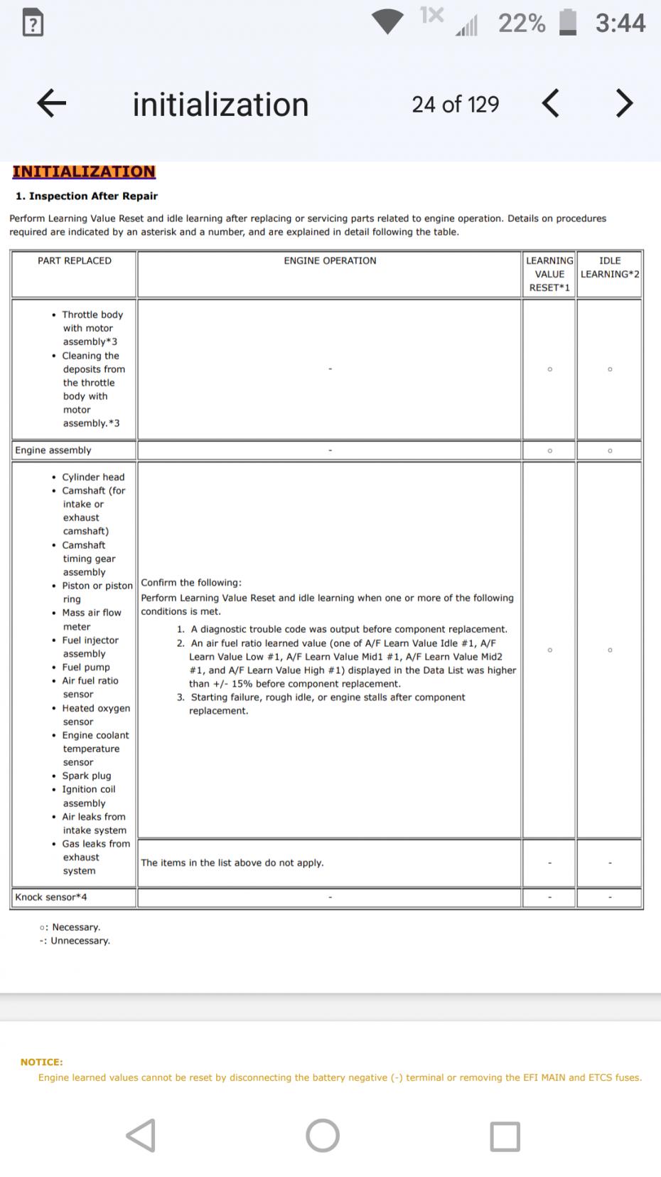

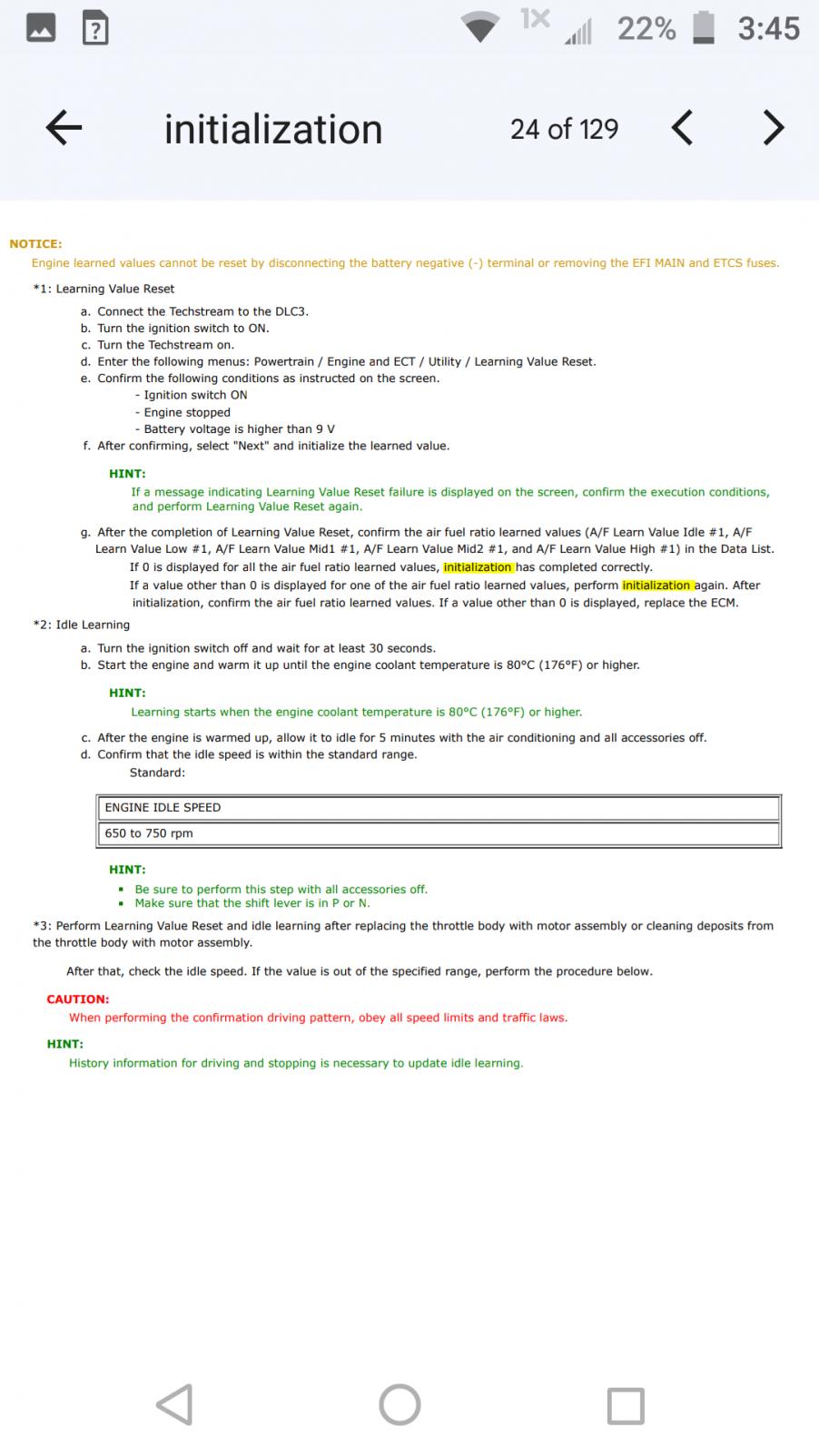

According to the Toyota fsm it requires techstream with no manual method available. This is obvious b.s., there is a manual/diy procedure via an ignition on/off sequence and headlights or parking brake combination to activate initialization and learning. I can't remember the exact sequence right now. I can't post this information due to controversy.. sorry big chiefs

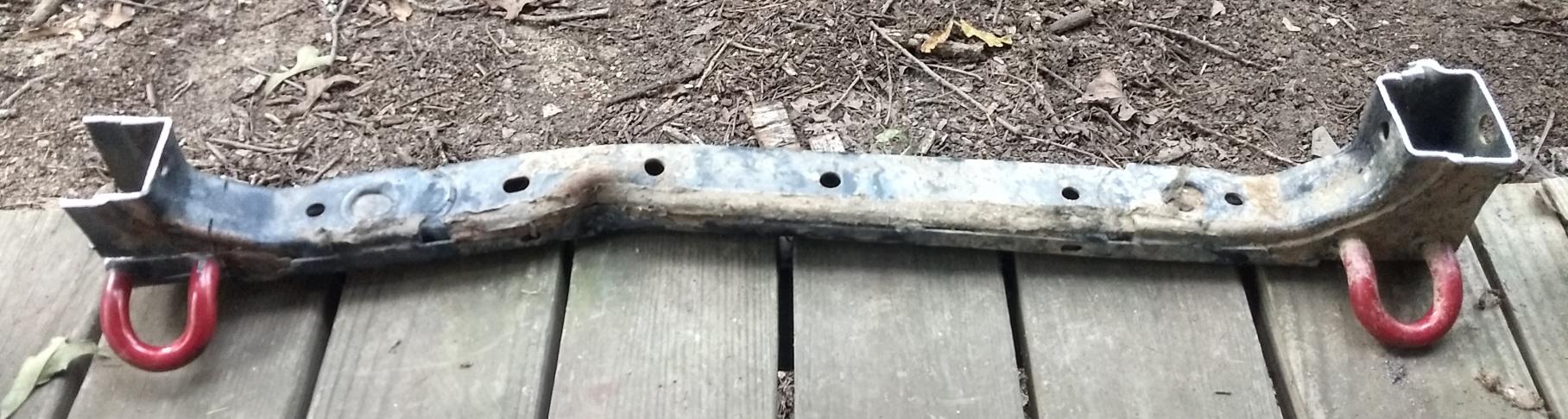

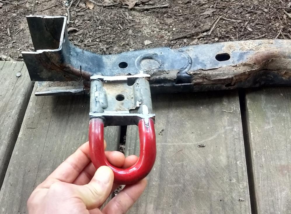

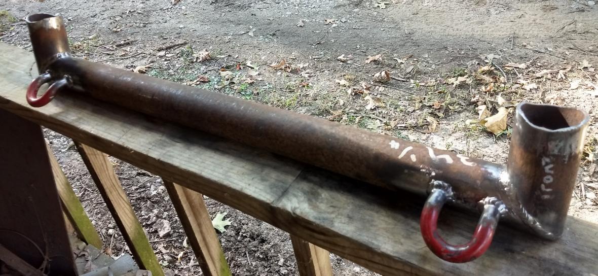

Yeah I didn't bother with that worthless tpms system when a sensor battery died. I couldn't stand the light though so I jumped a switch into the circuit to disable/enable the system. Actually really easy if you're interested.. by the way last weekend i f_cked up again going hard in the cut just made a new front cross member/skid mount built for about $5 , f_ck a shop
$5
