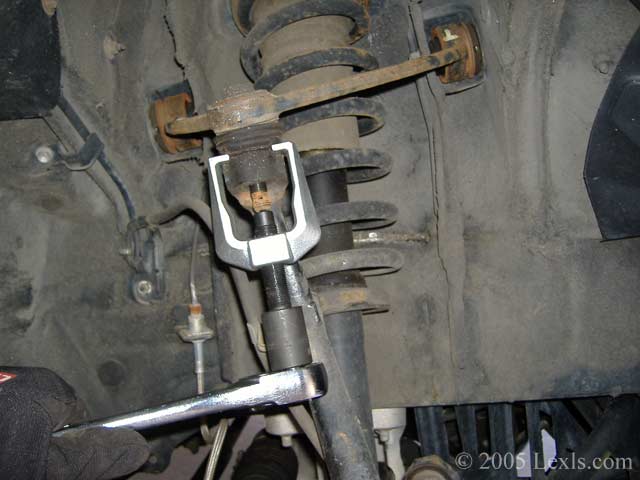

Had a similar issue...
This is the only thing that helped
More here

It's called a Pitman arm puller .. There are some places that rent tools. I can't remember where we rented that from but it's worth a try before you start cutting bolts. It's pretty effective if you have room to mount it

You think that arm puller there would work for cracking lower arm bolts?
What you have here is totally different than what Danny's issue is. That puller will not help your situation.
You will need to grind pound and melt unfortunately.
I was thinking that didn't look like my issue, but I'm no expert on it.

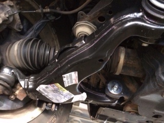

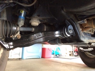

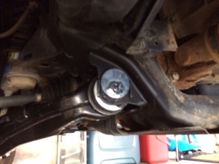

Here are some picks:
I like all the stickers left on there, it's a nice touch.
I don't see any markings on the bolts from the alignment. Shoddy work, or no big deal?
