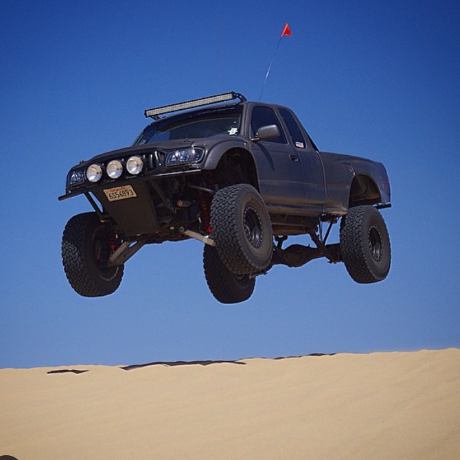

Would this work with a camburg long travel kit ?
If the Camburg kit uses the stock lower ball joint then yes I believe that it will. I haven't test fit it on one but I do have someone that has the kit on their 4Runner that I'll be test fitting it on.
Ok let me know. I'm assuming the uniball has more range of motion then the lbj? So when cycling a lt kit it won't bind before full droop or bump
In theory that is correct but I designed the uniball spacers for a stock application. I would have to see just how much joint travel a LT kit uses. It would be a somewhat easy fix to add some misalignment into the spacers, but might not be needed. I'll definitely be looking into it soon.
