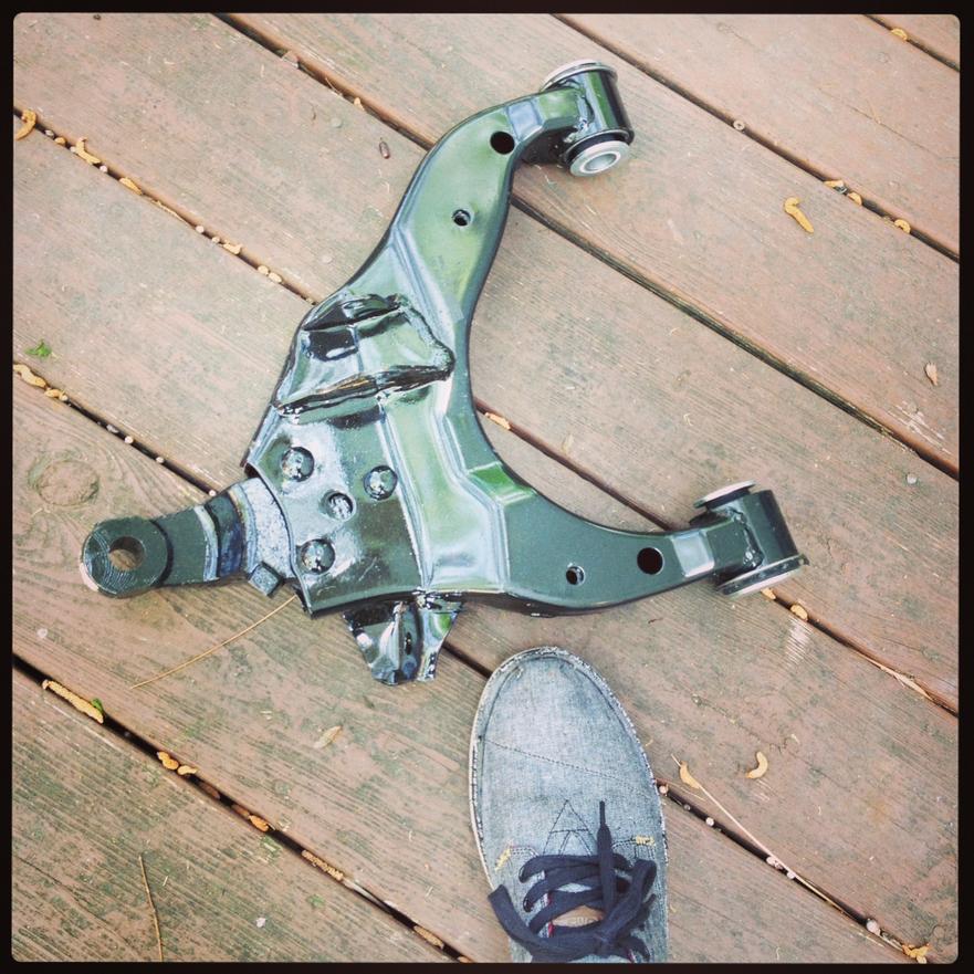

Lower Control Arm with bushings
I ended up finding this on Rock Auto .com It's made by Dorman and was shipped to my door for 60 bucks. I found other sites that sell the bushings individually but since my control arms are rusty I just figured I'd replace the whole part. Best of Luck!

Brave souls - Might check out that LCA as an option. I bought a whole set of ES bushings from Toytec and was going to change them all out while installing the lift. Got to the point when we were trying to get the big bolts off the steering rack and also realizing that we were probably gonna break the OTRs due to rust. Then decided the bushings were fine for now. I think it would've taken the whole weekend just to do the bushings and the lift wouldn't have gotten done. A job for another day -
