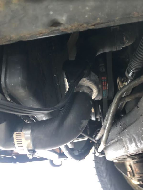

What is going on with your lower radiator hose? You have some intermediate assembly in there that I've never seen before?
Might be the angle of the pic but that's the coolant heater there, with the belts in the background not related.
I'll see how she goes tomorrow morning, it's just getting colder and colder this week. This morning 2 cranks to turn over, at lunch when it sat unplugged for 5h it took maybe 7 cranks.
If I get bored/nerd out I may look for a better spot to plumb it in, ie somewhere behind the thermostat. Just hoping the diameter of the heater I have would match the new hose location diameter.
Thanks everyone!

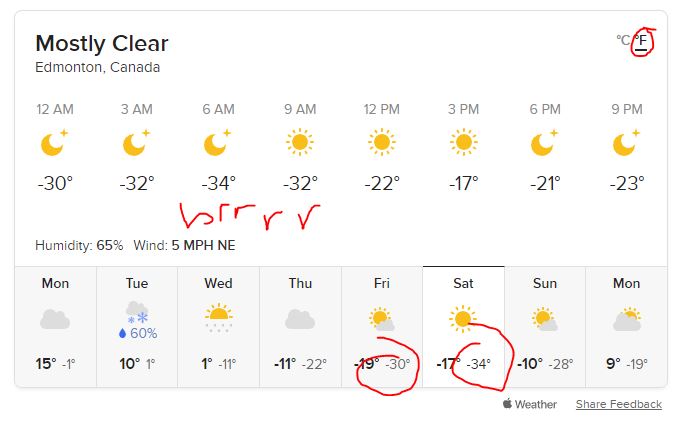

He posted the weather for Edmonton... And -30's*F for overnight temps. I'd go for some sort of pre-heating if I was going to drive there in the winter...
