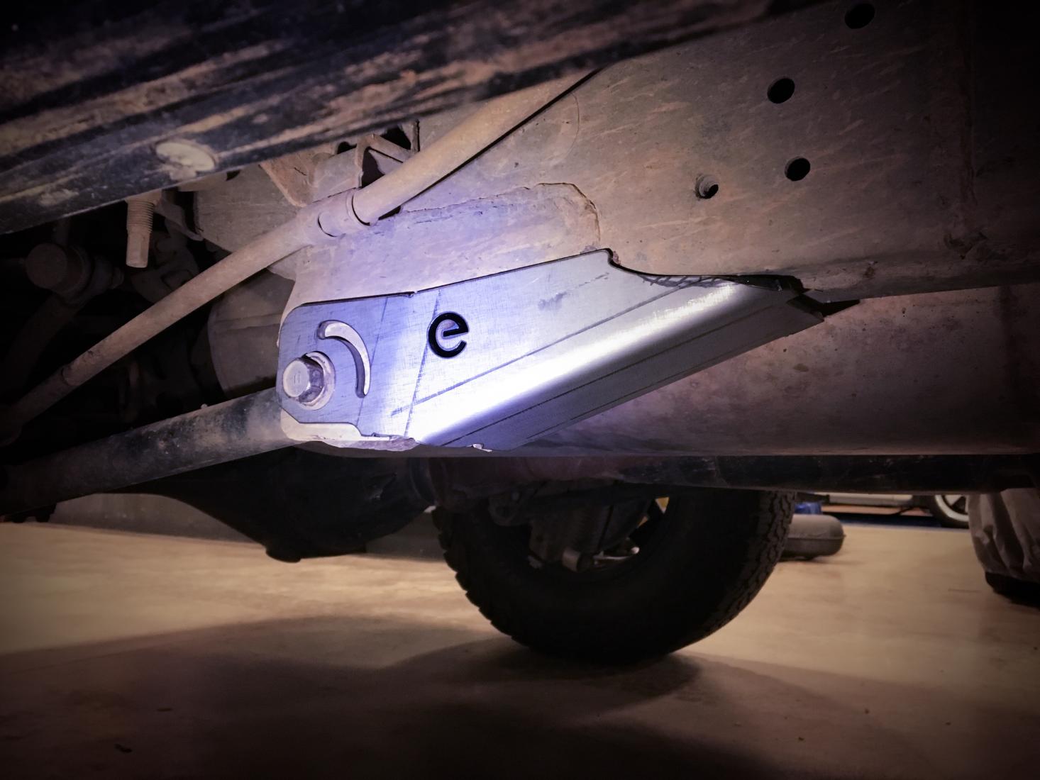

The lower link mount reinforcement skids for the 120 platform are in!
The parts from this initial run require minor trimming in two places during installation (the area with the hatch marks is the worst of the two) - so I'm marking them down 25% to blow them out. Great opportunity to get a set for cheap right now. :)
they can be ordered here: eimkeith.com/buystuff/lls
