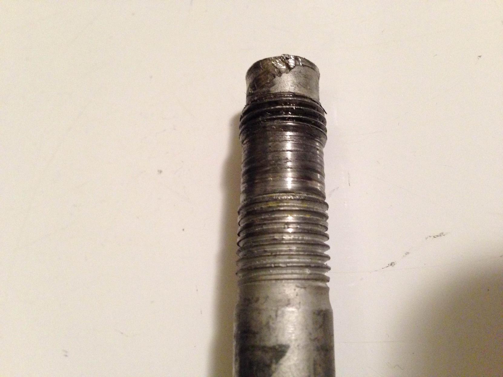

I stripped mine trying to tighten it back up after swapping my 5100s in. Nut ate the threads right off. This was 15 minutes after the Toyota dealership closed and on top of that, there was nowhere else to get it. Ended up having to wait til Tuesday to fix it. :frusty:

Just an FYI for you and anybody else who runs into this. One of my lower bolts seized and I had to cut it apart, these bolts are not stocked at Toyota so I ordered one but was out of luck at the time which is a problem because I DD my truck. Ran to ACE hardware and picked up a bolt that fit. Ran it for a couple days no issues and keep it in my spare parts bag now. I believe it was an M14 x 3". Take your bolt with you to compare sizes just to make sure. I've got an OEM bolt back in there now but as far as getting you through a couple days it'll do.
There's nothing special about that bolt lol. Maybe if you really wanted a smooth collar and not fully threaded then you would need some washers to space the nut out to torque it nicely... Otherwise as long as it's snug doesn't matter, hell a grade 5 would work totally fine I bet.
I agree on the hardware store parts. They are usually just as good for what is needed as what is found at a dealership or auto parts store. If you manage to shear a brand new lower shock bolt in half, well, let's just say you're lucky you only sheared a bolt!
The more common problem is finding one with the same size and thread spacing. I often find the right size bolt only to find that the threads are too big/small.
