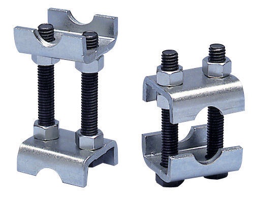

You can't cut the 4Runner rear coils. They're the pigtail style, they won't seat right. The cheapest/easiest way is the coil clamps (can get them at any parts store). I don't recommend them but can't see why they wouldn't work. Would also have to cut your bump stop down.
