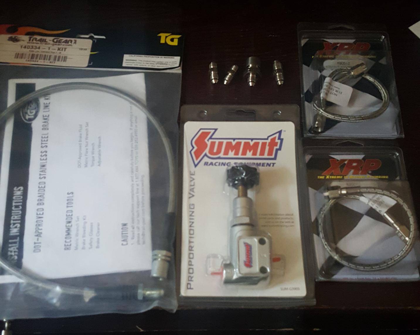

Doing a LSPV delete on a 90. Decided to start a thread for you all to see.
Here are all the parts i need to do it.

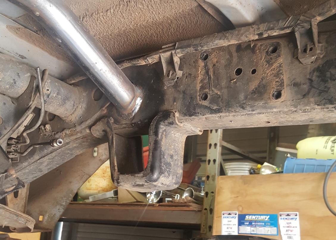

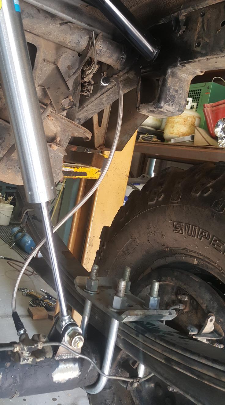

Removed the LSPV and installed a trail gear stainless line to the feed line.
Feed line is the top on facing the front of the truck. I shorted it and flared it so it wasn't to long.
I cut the end off the return line and just bent it out of the way. Will remove whole line later, was using buddies shop and had to finish it.
I know it's not done yet but might wanna check the passenger side at full droop. Brake line might be too short
The picture show's it on the lift with no weight on the tire's nor the tire's touching the ground. I'm sure the line is long enough.

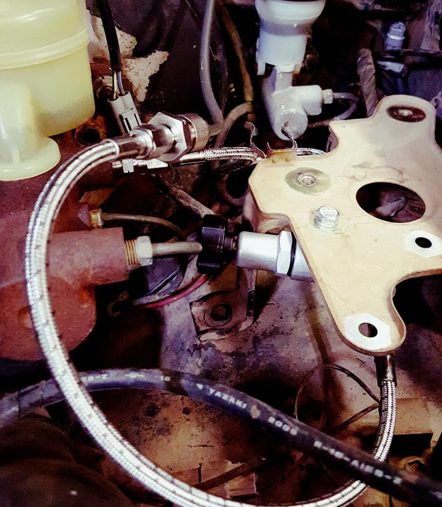

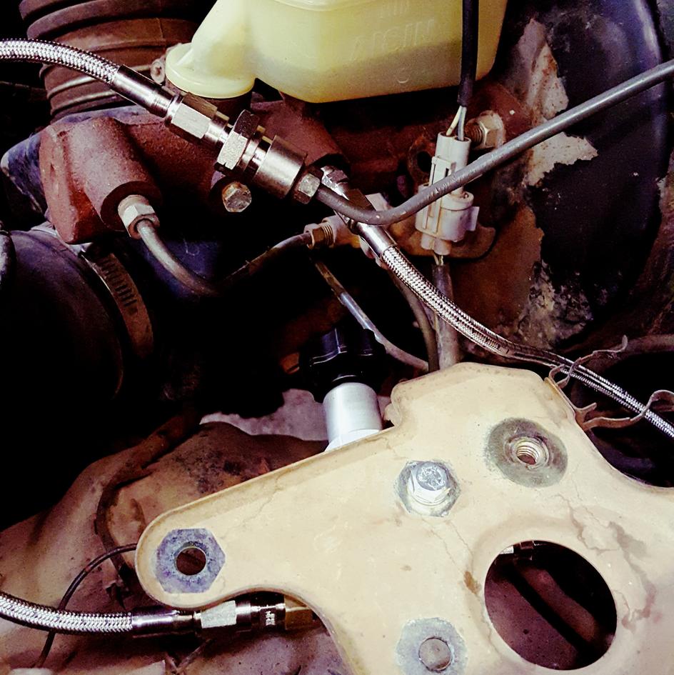

Sense my cruise control doesn't work (after market wheel) i used the mounting plate for the cruise control to mount my proportioning valve. Used fittings and stainless line to hook up to the master.
Still need to do some adjusting and road test, but i cracked my rear axle housing so i'm not driving the truck till that is fixed.
