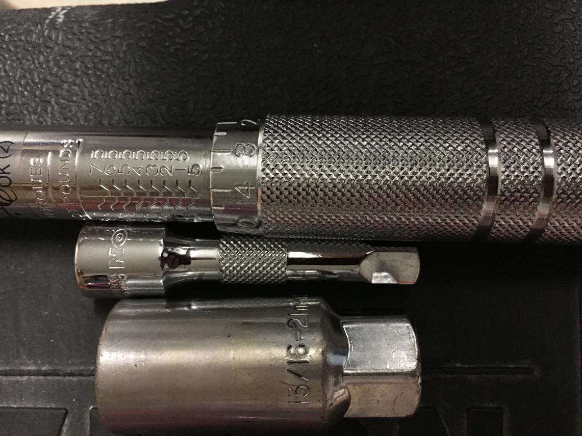

A 13/16" 6 pt deep spark plug socket has worked well for me. It's actually slightly smaller than 21mm (.8125 vs. 0.8268). I've got one that has both measurements inscribed on it.
