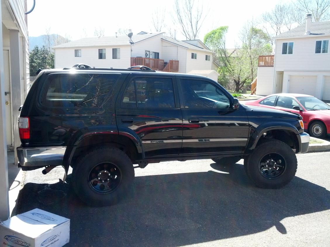

I picked up some 16x8 pro comp 6089 wheels (shown) for my truck. I was planning on just using the stock lug nuts for a few days until my black ones got here. Well the tire shop went to put them on and the lug nuts wouldn't fit very well, the stock ones have washers on them and so it sets on the front of the rim face, rather than where an angled lug nut would.
After some research I know that my wheels are lug centric, whereas the factory wheels are hub centric. This should be fine, but I need to make sure my lugs are good. Options include E/T, acorn, 60 degree slant, different shank styles.
So does anyone have the correct lug nuts on their pro comps (hopefully 6089s) on a 3rd gen that can tell me what to get?

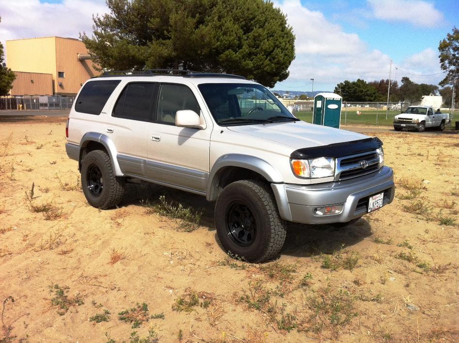

i got mine from 4 Wheel Parts
call um and say you need the lugs for the procomp 8069s. For all four wheels mine ran about $40.
I've got the same wheels (which are 8069's btw, not 6089's)... I used Gorilla Lugs, part #41138ET.
Gorilla 41138ET $1.29 Chrome Lug Nuts E-T Ultra Tapered Mag Seat, Bulge Seat 3/4" Hex Head 12mm x 1.50 Thread
The lug nuts fit the wheels' lug bore perfectly, the ET section of the lug helps center the wheel, extra threads gave me 14 turns of thread engagement, and they're a 3/4" drive so I don't have to get a thin wall socket to get them on/off.
The ones that Hepar linked above will also work, but they are not an extended thread design, so you will have less thread engagement... but they are black.
