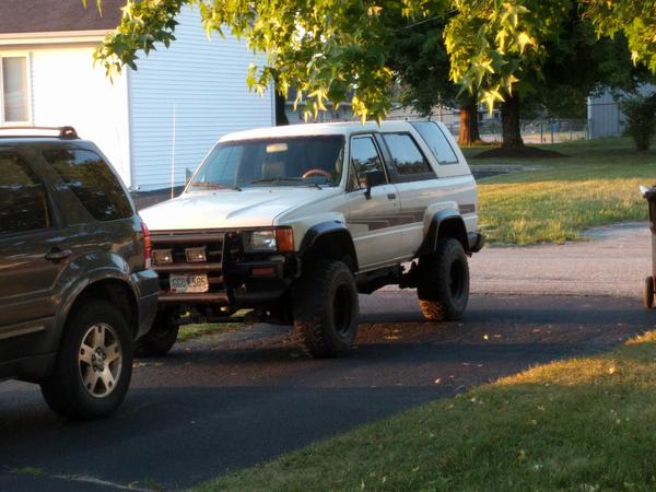

magnet18's 86 4runner build thread
magnet18
build/restore/mod, I'll put it all here-
helloooo :behindsofa:
I've been wanting an 80's hilux/4runner for a couple years now. (ever since that top gear episode on killing a hilux) Finally graduated and got me one!
Shelled out good money for one with no rust, unfortunately a lot more than some of you desert-dwellers can pick a nice one up for, but an almost rust free frame in Indiana is priceless
170k miles, needs a little tlc but it is solid through and through, apparently lived in cali until 2 years ago.

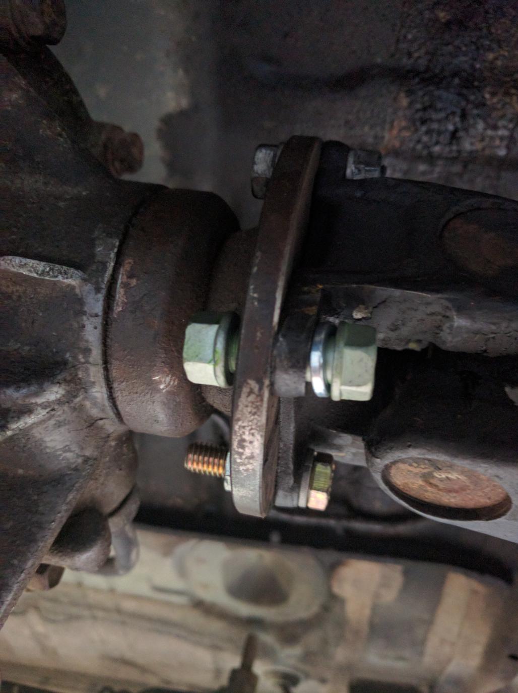

•bolted driveshaft back onto tcase after it started coming off going down the road... hope that was a one time thing

Cross the driveshaft bolts off the list!
Old on top, placeholder on bottom, new in the middle

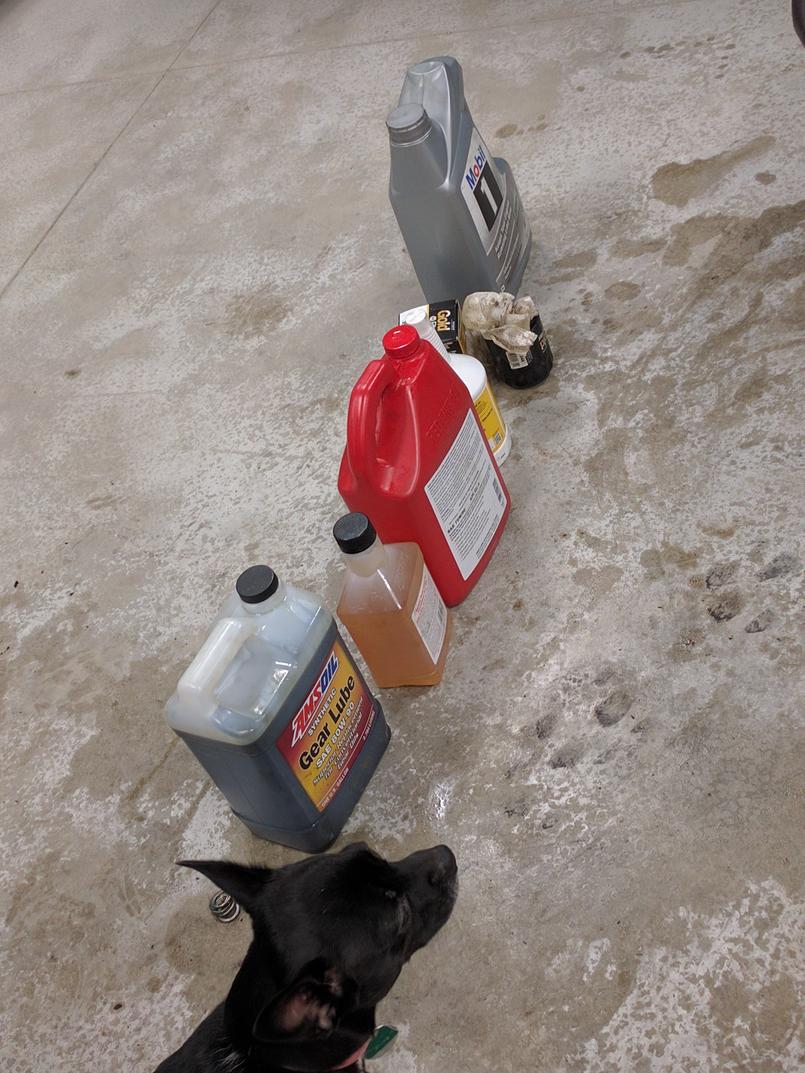

Changed allllll the oils with synthetic
Perfect way to spend a Saturday :D
Diffs got amisol synthetic 80w90 gl5
Transmission and tcase got redline synthetic 75w 90 gl4
Engine got mobil1 full synthetic 10w40
Napa gold filter
172000 miles

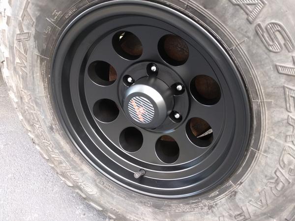

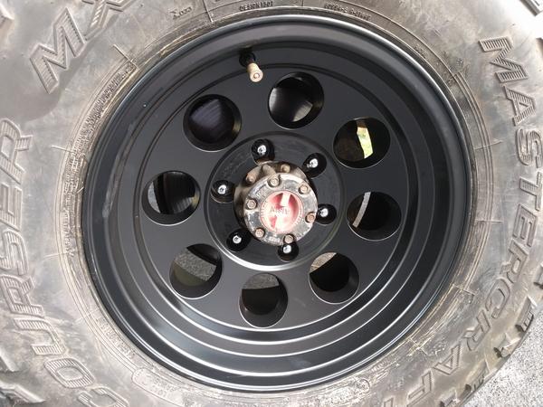

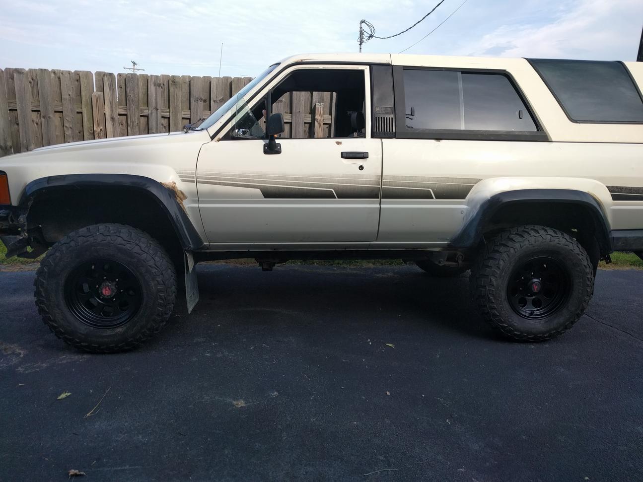

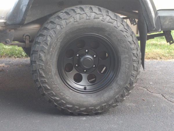

New Rimz
Pretty Sweet
Dang my hubs look terrible now. Need to do something about that.
What is this?? A logo???? Disgusting.:puke:
I can fix this
Much better
Best of all, much smoother ride on the highway now!

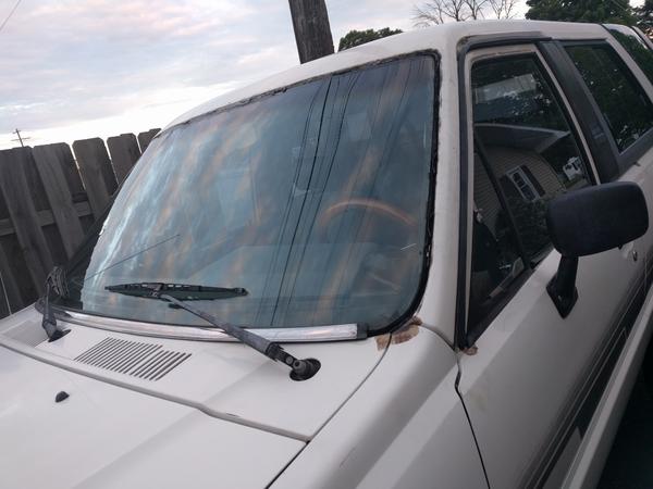

1. fix the windshield seal ASAP... someone ripped off the chrome and it leaks
...anything i need to be concerned about as far as windshield places messing up the gasketing?
Ditch the chrome. It traps dirt and water, keeps the cap moist and promotes rust.
U.S. 4Runners do not use gasket. Urethane adhesive is used to mount and seal windshield glass. To properly fix the leak, you would need to remove glass, fix rusted spots- yes, with your POR-15, re-install glass.
