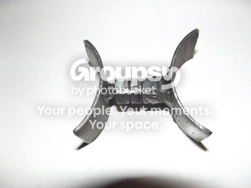

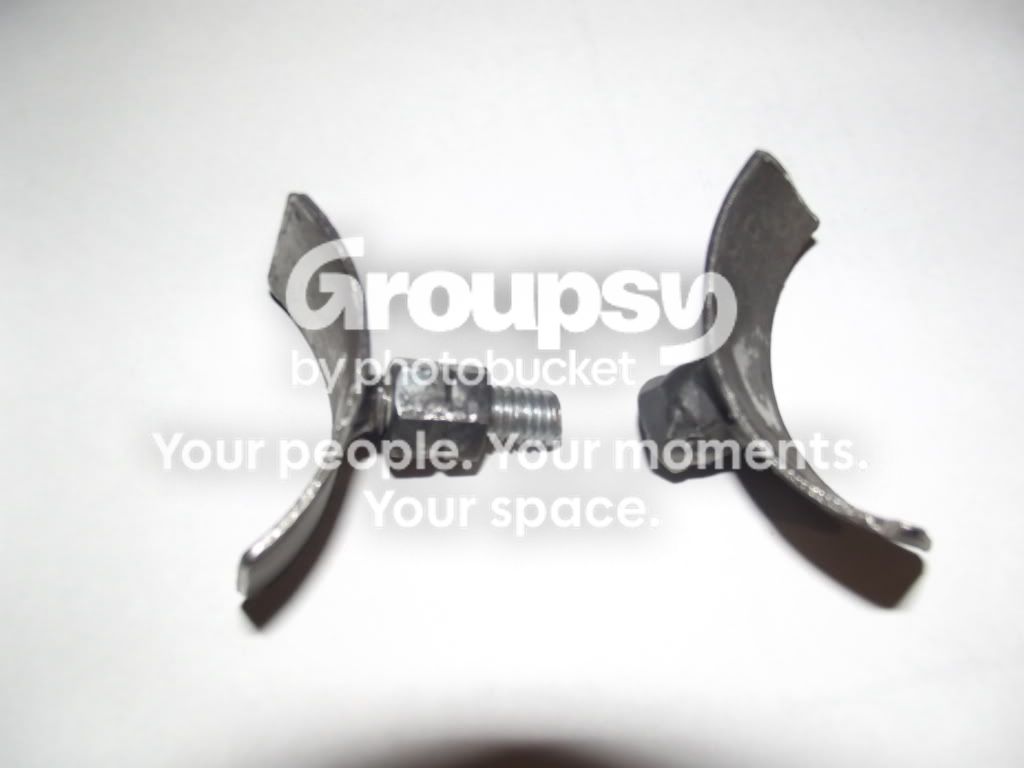

Btw, if you are handy at all, and like to McIver your own stuff...you can make your own Tensioner tool with some exhaust pipe, a threaded bolt, and a few nuts....
Here's the one my buddy made for me:
DSCF5658.jpg~original
DSCF5659.jpg~original
Saved me $50.00 by making this one!
Good luck!
