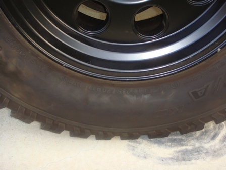

Making 285's fit without rubbing

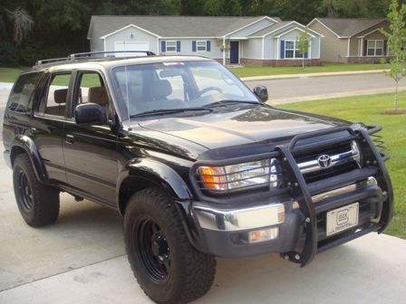

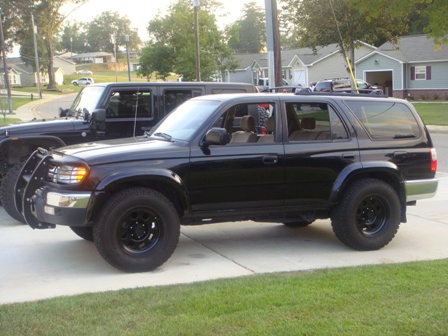

LOL, thanks for the advice. I already have the tires on but my pinch well is cutting into my right tire alittle and the front portion of the fender flare is doing the same whenever I make a full turn to the left or right. It appears as though I'll have to atleast trim the fender flares alittle and either grind down the pinch wells or beat them down with a ball pin hammer or something until I can get rid of the rubbing and cutting of my tires.
Well the deed is DONE. I took her to the chop shop and did some trimming and banging of the pinch welds until it didn't make anymore contact with the tires, but I still get some rubbing from time to time depending on the load. Once I get the Toyotec Ultimate Lift with 1" BL I should be O.K.. We'll see, eventually I plan on moving to 35's like my jeep and moving the jeep to 37s. It's a work inprogress.
