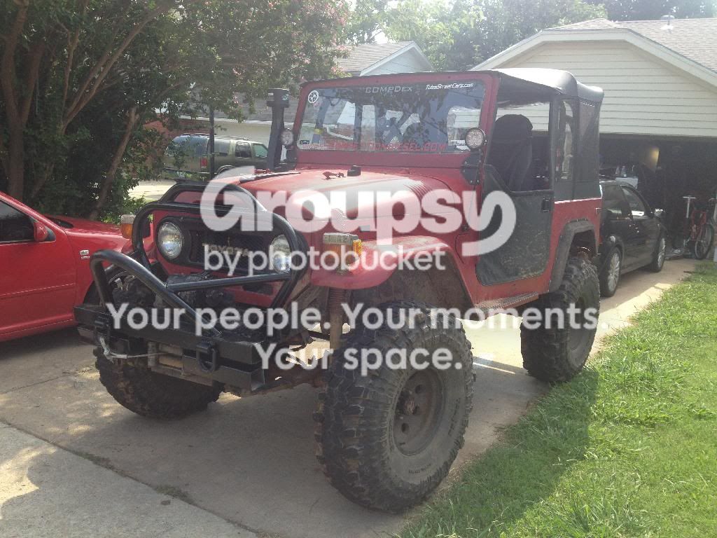

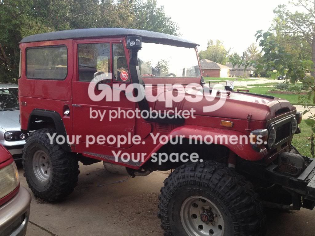

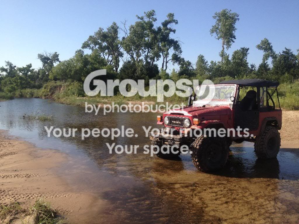

Here is a pic of the FJ40, whom the 4Runner is giving some much needed relief to.

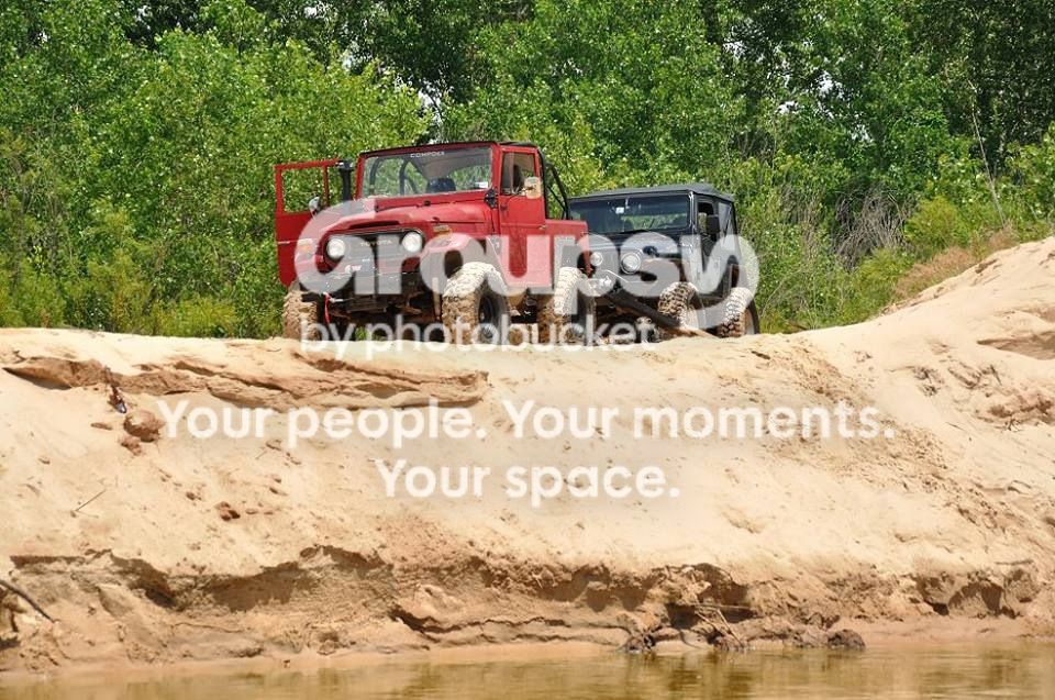

Here are some pics of the 4Runner.

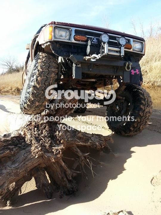

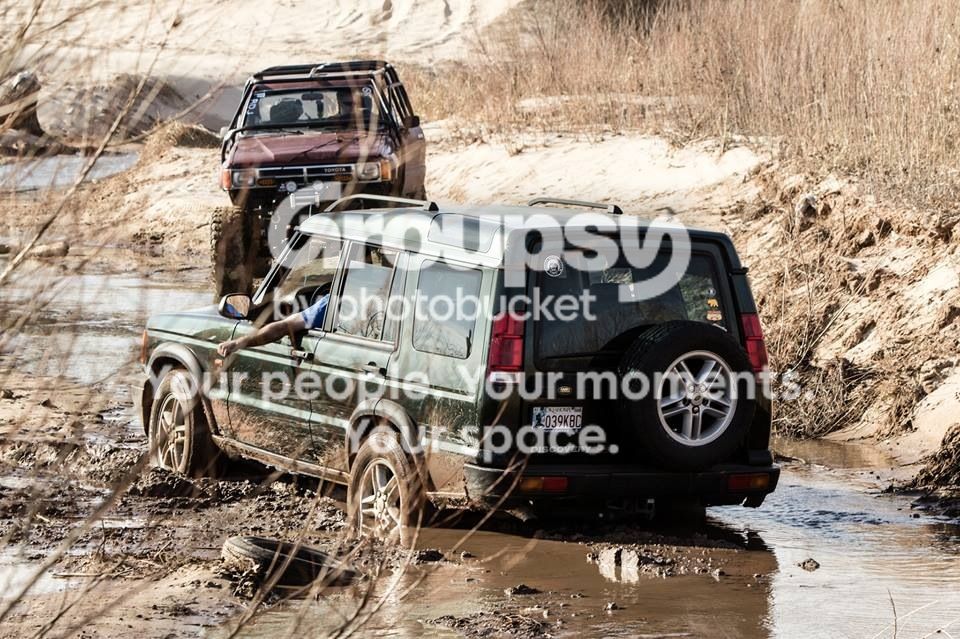

Pulling out a Rover:

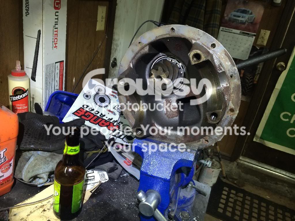

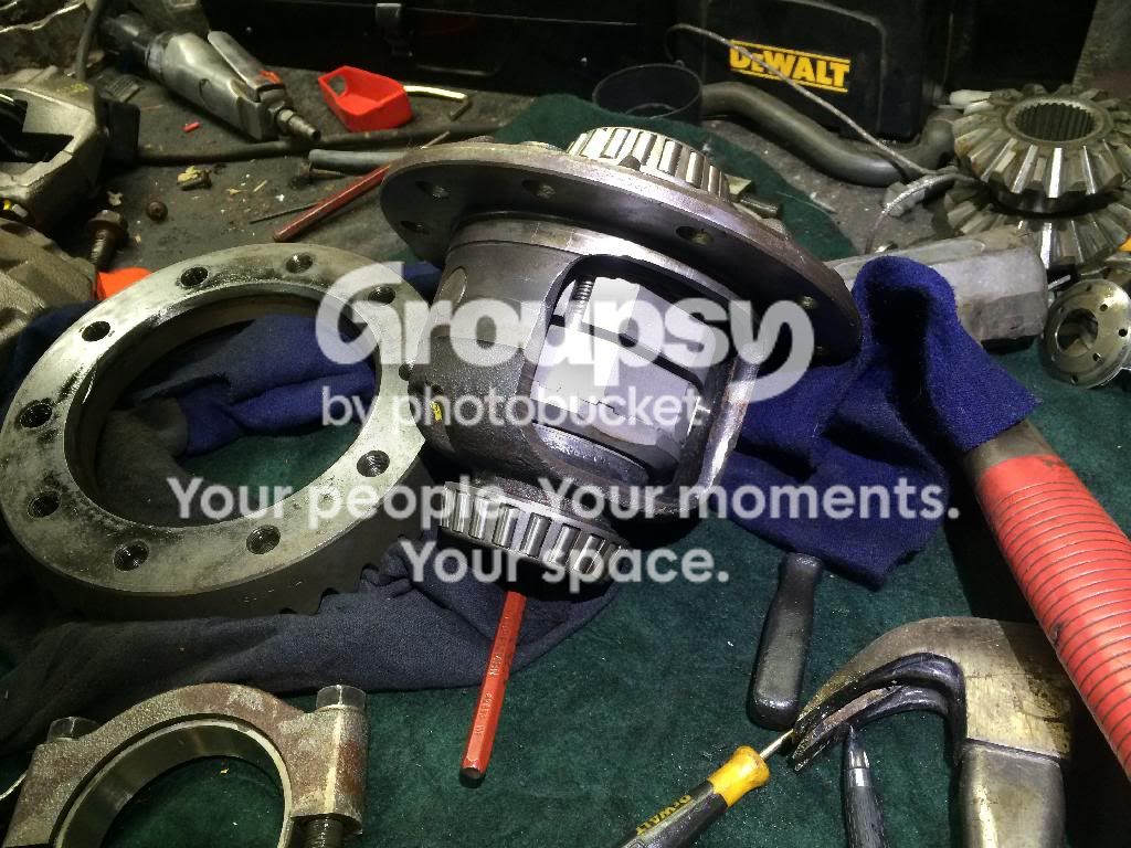

Rebulding the rear axle/3rd and adding disc brakes.

Thanks fellas! The FJ40 is my baby, and that's part of the reason I wanted to give her a break and spread the offroading duties out a little. And I've always wanted a 1st Gen 4Runner.

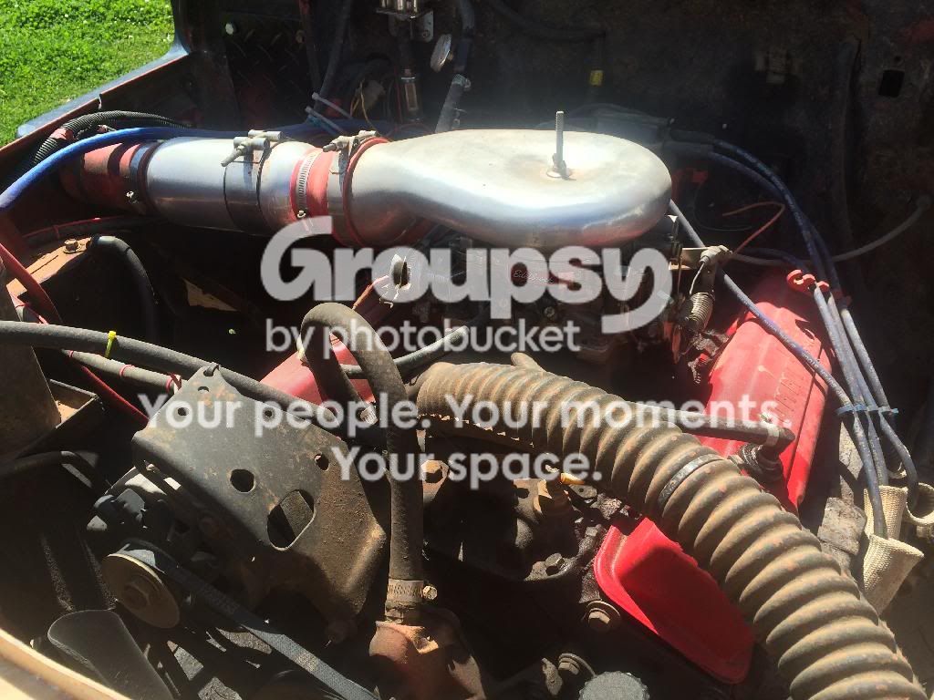

It has an SBC 350, SM465, snorkel, dual batteries, locked front and rear, warn m8274, 38" TSL's, trac-bar, full cage, 5 point harnesses, lockable center console, FJ60 heater, custom dash, 4 wheel disc brakes. Its a hoot.
Here are a few more pics of old red. Some are from a little while back.

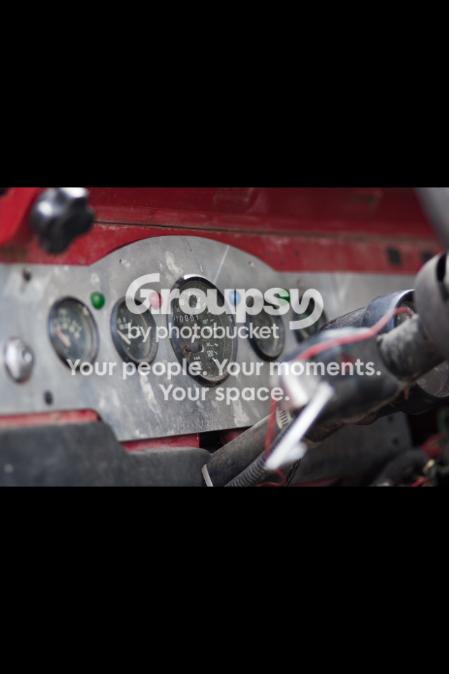

The dash

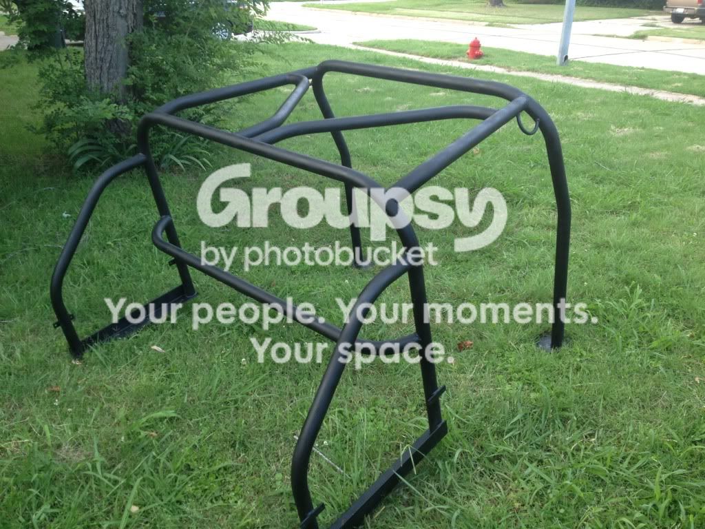

Here's the cage I made for it
With the hardtop on.

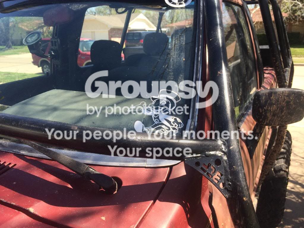

Thanks for the compliments! Yeah, I thought that sticker was perfect, given how slow this sucker is at getting up to speed. That CB in the dash was a HUGE pain. I had to pull the dash apart, and then i had to take a heat gun to the air ducting and mold it to fit. In the end it turned out perfectly though!
Question on your exo-cage. Does it come apart to take the back off or do you have to slide it out the rear? Been thinking of doing something similar with possible disconnects to keep top removal easy.
