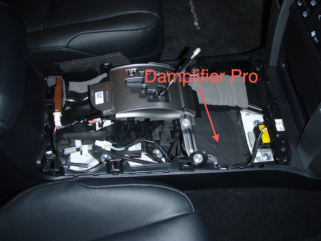

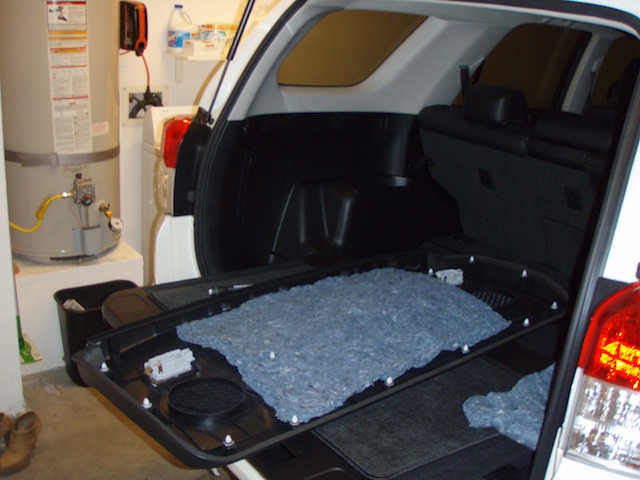

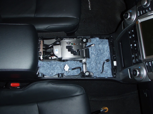

That is the first thing I noticed when I drove the new 4Runner home on the highway was the excessive road noise and tinny door. Here is a list of what I did to reduce the road noise and eliminate the tinny door feel:
1. Installed Second Skin Damplifier Pro on the outer door shell and replaced the plastic moisture barrier with another layer of Damplifier Pro.
2. Layered the door panel trim with Damplifier Pro and added some UltraTouch insulation.
3. Lined the rear cargo area with Second Skin Luxury Liner pro.
4. Lined the rear hatch door with Second Skin Luxury Liner pro.
5. Lined the rear hatch door trim with UltraTouch insulation.
6. Filled front driver and passenger kick panels with UltraTouch insulation.
7. Applied some Damplifier Pro to the transmission tunnel and filled center console with UltraTouch insulation.
After spending about 16 hours over several days and roughly $300 for the material I must say the 4Runner is as quiet as our Mercedes now. There is one caveat, you'll add about 45lbs. of weight to the vehicle with Luxury Liner pro installed. Hope this helps.
