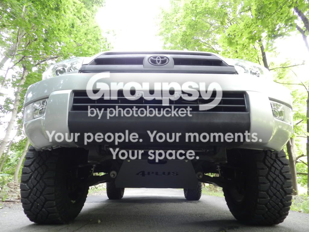

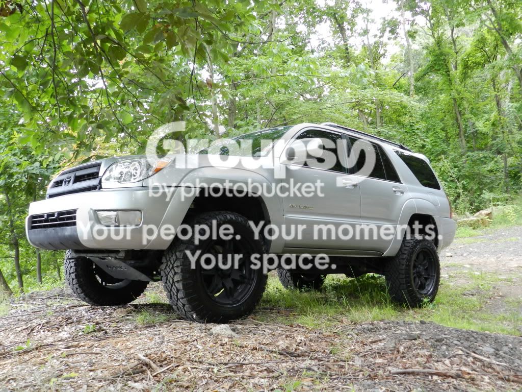

Man-o-fre front skid plate...
nethngbtstk

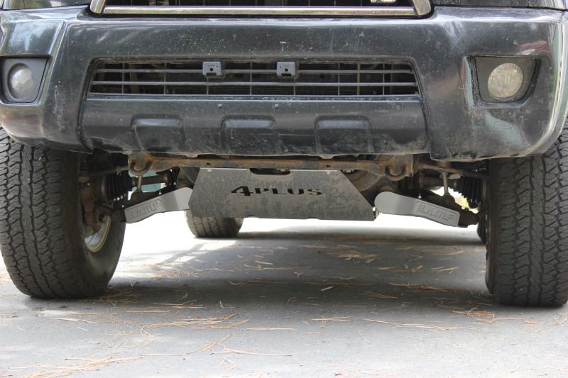

is NICE!!! Definitely happy with the looks and added protection.

Looks great! I really like what the skid plates do for the appearance even. It just cleans it up down there.
My thoughts exactly. Just looking at the front of the truck it has this beefiness to it now. It just tied the front together so well imo.

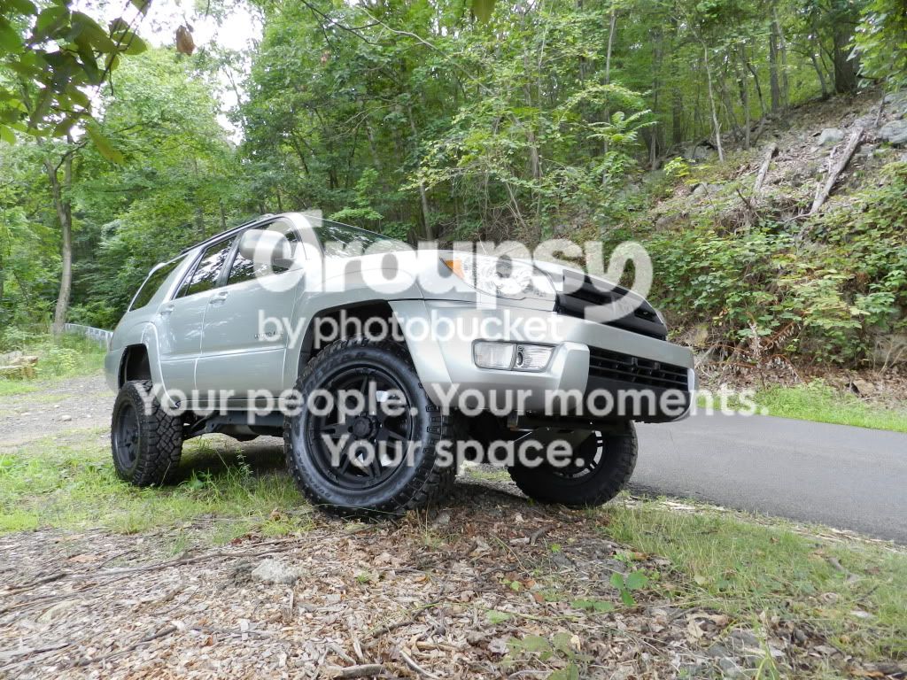

Hope this doesn't rain on your parade but I got the Expeditioneers skid for those who haven't seen it. It's essentially the same as the Man-A-Fre/4+ skid but has the degrees, minutes, seconds (º ' ") logo instead of the "4PLUS"
Here's a pic

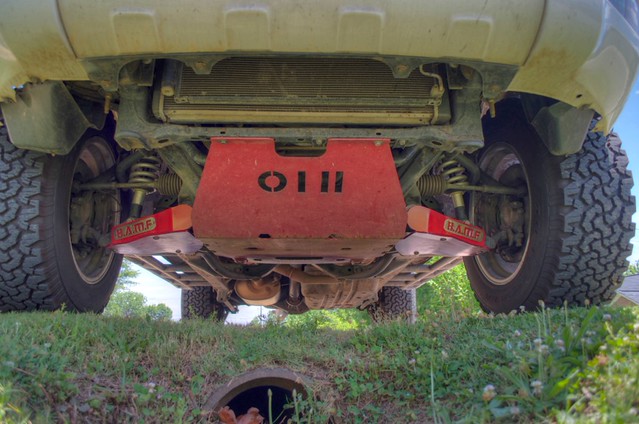

It only looks better with a set of BAMF lca skids!

looking at both your trucks the lca plates you have, any issues with fitment or dont even know they are there? Quick search online looks like they are about 150 bucks give or take. You definitely say worth it? Looks sharp and again added protection is a win win....

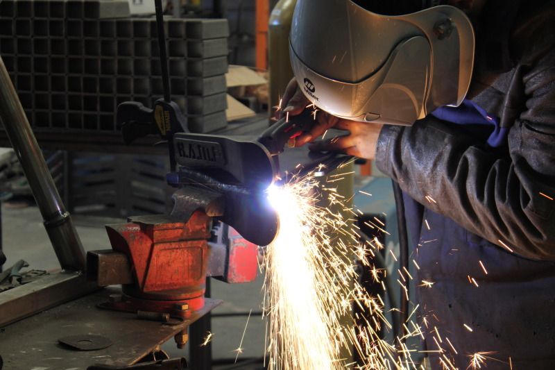

BAMF's lca skids are built to last, seen it in person:

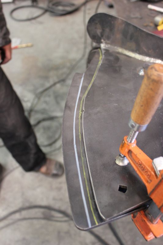

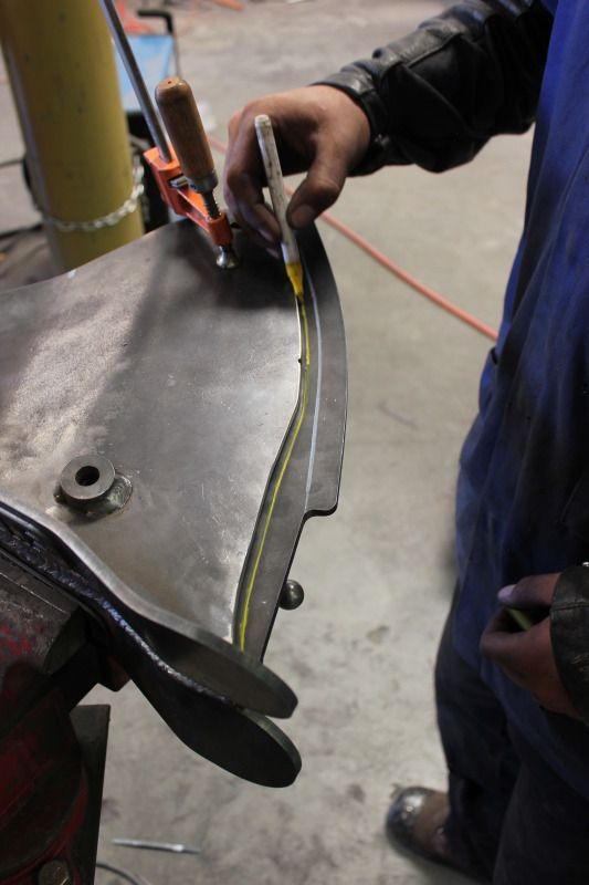

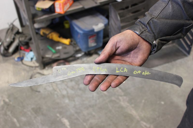

For BAMF skids to properly fit at full droop with 4+ skids you will have to trim a little more than an inch from the long side:
4runner028.jpg~original
4runner030.jpg~original
4runner034.jpg~original
But dont worry, Jerry at BAMF has a template for these skids!! "4th gen LCA cut off"
